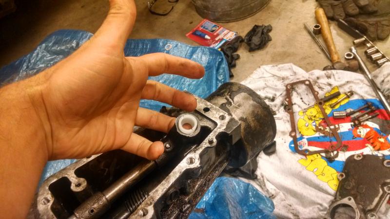

    IMG_20140724_165222483_HDR.jpgIMG_20140724_165236963.jpgIMG_20140724_165252740_HDR.jpgIMG_20140724_165302445.jpgIMG_20140724_165509507.jpgIMG_20140724_165208960.jpgHey How's it going? Thanks for having a forum like this. I've already found it to be a boatload of help and decided i should probably introduce myself since ill be using it more. I'm Matt 23, have had this truck about a year now and have had only minor problems with it, actually learned stick on it as well lol. but recently had a tranny problem, it got stuck in second and wouldn't shift out, figured it out after pulling the tranny it was just the little plastic cup at the bottom of the stick broke in half, and thanks to a helpful brad on here got the part number and am about to install it.

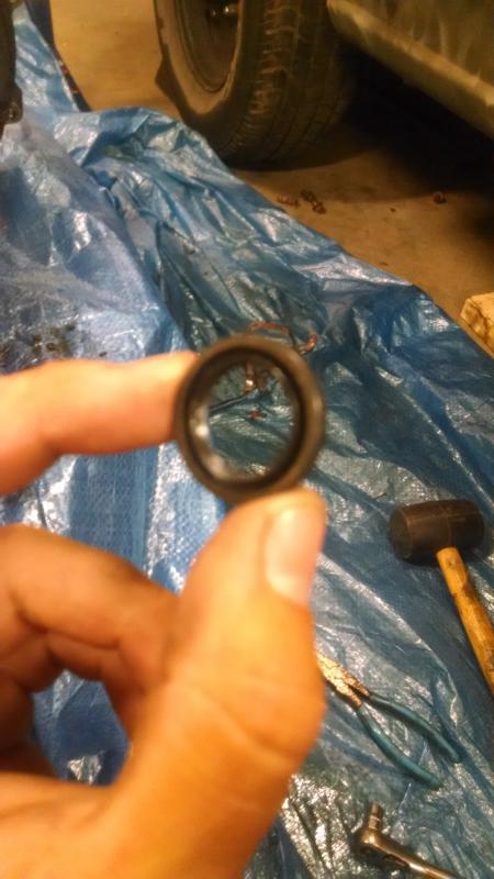

    thanks for the input guys! i did not paint the truck but bought it like that. pretty sweet paint job though i love it. gonna go check out that gear oil now and talk to the guy at the autopart store. just had another question about my top fork being a little loose and if i should look in the upper housing or not. got a video will post in a min. also random gasket that came with this set, where should i be looking to find where it goes? dont have a manual or anything. IMG_20140725_155454083.jpgIMG_20140725_155501650.jpg

    My guess is that the random bearing fell out of your speedometer cable junction when you removed the cable.

    Will it still work without? And gotta get into the upper housing to put it back?
    There are a couple of ball bearings in the transmission and you really need to make sure they find their way home - one in the reversing switch (everyone has dropped that one) then there's the one in the right side of the gearbox extension housing that drops down into a gallery from under the top cover (it act as a locator for the shift rod) If you've removed the top cover on the extension housing this is more than likely the one you've dropped. It is held down in place by a spring that is pre-loaded by the top cover. Without it the shift will feel all out of whack.

    Made another video! On the camo ram page ^^..how does the bearing sit for that spring? Just right underneath it? Hopefully bid helps. Or if you know a where I I should be looking for the diagram or manual that's has the shifter assembly. The mistsu manual I found on here only had the innards of the tranny.. Thanks
    Yep CamoRam, just drop the ball bearing into the gallery and sit the spring on top of it. The spring will protrude about 1/4" out of the gallery and when you replace the shifter mount/top cover it will compress the spring and load up the bearing.

    Hmm this bearing is bigger then the hole..lol gonna have to take a look and see if this is another bearing?
    1,271
    This is seriously my bad: I meant the back-up light switch connection. As I recall there is a ball bearing in that switch: I had the same 'mystery bearing' appear when I removed my transmission some months ago. I finally figured out it goes in the back-up light switch.
    Did you check to see if it fits in the reverse (back-up light) hole?

    where is the reverse back up light switch located? want another pic or vid? thanks royster
    The back up/reversing switch is located about half way down on the right side of the extension housing - you can get to it from under the truck but the cross member will make it a challenge. It is kinda hard to get the bearing back in there once the transmission has been installed though...

    What Geezer said...thing is, you had to disconnect it in order to drop the transmission, so it should be the only electrical connection you have there. I don't remember if it has a small spring or not, but this is what I think the "loose" bearing is from.
    I'll look it up in my Hayne's book and see if there's info on it
    EDIT:
    According to the manual, we're supposed to disconnect the back-up switch near the steering box.
    I didn't.
    I disconnected mine right at the transmission, and had to contend with a ball bearing.
    The ball bearing is held up into its seat by the back up/reversing switch actuator rod (the switch assembly has the mechanism built into it so at least there's one less thing to go missing). There are 2 bullet type connectors on the end of the switch assembly wiring.

    hey just wanted to say thank-you! was able to find the reverse light switch bearing placement and also got lucky enough to find a bearing that fit into that top load spring gallery. slapped it in yesterday and am happily on the road!
