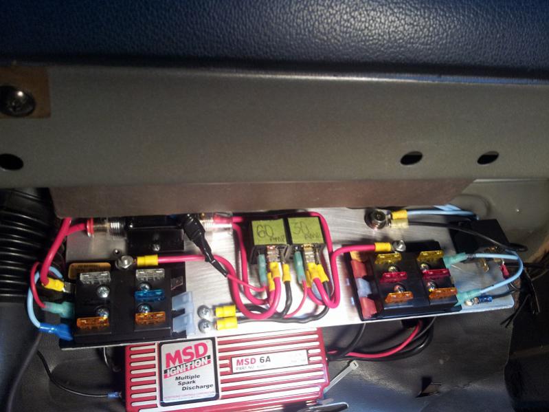

    update re-do!
    I hope I'm going in the right direction on this? I'm doing a separate 60 amp service jumping of the starter/battery cable(less 10 gauge wire to run) for the air compressor, fuel pump and fans. The million dollar question is we only have so many ignition switch hot wires to kick the relays in, how many do I really need?
    I'm going to run a fuse box to boot for each separate power supply.
    This isn't all the relays I have, it's the only ones you see. This bolts up underneath the dash behind the glove box where the air conditioning use to be.

    Quote Originally Posted by Rickdees View Post
    Answer, run one ignition switch hot wire to a "main" relay #86, then run from the "main" #30 to the other relays #86.

    update
    Ignore post 17 and 18. I went this way with a 60 amp breaker 60 and 30 amp relays and then fuses to double down.
    Online
    3,847
    That came out nice and clean looking. You should get some shrink tubing and shrink it over the solder less connectors. Just in case you drop somthing back there it won't burn the truck down.

    Thank you. That's kind of like what my one son said, but he started with Harbor freight. I'll get a small fire extinguisher too.
