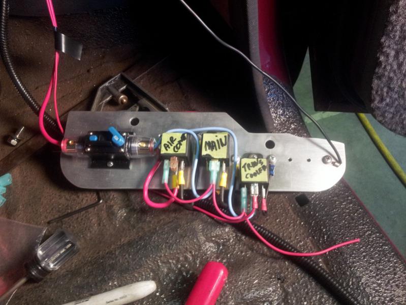

    Quote Originally Posted by Rickdees View Post
    The million dollar question is we only have so many ignition switch hot wires to kick the relays in, how many do I really need?
    Answer, run one ignition switch hot wire to a "main" relay #86, then run from the "main" #30 to the other relays #86.
