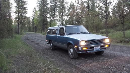

Problem: Carb has a "flat spot" right around the RPM's you release the clutch at (no tach). When moving from stop you have to over rev for it to not stall, not red-line though. Once moving I simply shift at higher RPM than I normally would to overcome this "flat spot". Temperature of the engine/ambient temperature does effect this "flat spot" but once engine is warmed to proper temp she isn't 100%, but manageable. Not a choke issue, it will idle cold at proper RPM and adjust as temp changes. I drive appx 8 miles on the freeway and it runs fine at speed. Same with back woods and dirt roads. Mechanically it's a sound beast just this stupid "flat spot"....
I want to re-affirm that you can power through this "flat spot", because of this I don't believe it's a WOT issue or fuel or ignition. Feels like it's "leaning out" but once higher RPM it catches up with itself. Electric pump and mechanical pump it had before both had this issue. Fuel pump got changed because diaphram inside.
So my plan was to not rebuild the carb completely, due to it operating normal except this "flat spot". I was going to start by taking apart accelerator and other items. Have rebuild kit but don't want to mix up any of those vacum lines blah blah
So any help I can get from someone with this issue or who really knows these factory carbs would be appreciated. Thanks in advance and if I can help anyone out or be of assistance please don't hesitate to ask!
