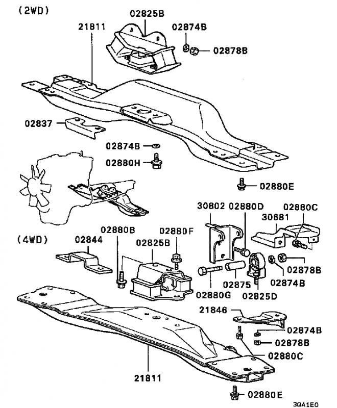

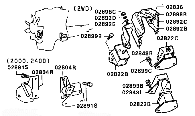

    Nevermind. But if anyone could tell me the motor mount specs. It would be much appreciated.
    2,367
    Hey LittleRam, what kind of specs do you need? Still having problems with getting that motor in? Remember we have manuals that you can download for your vehicle as well as info on torque in our Wiki threads.
    Can you maybe take some images of your motor mount issues? what your having problems specifically with on them. Usually not too many have problems with these except when I tried re-installing new ones, which was a bitch to line up. Good ole 48 crow bar and a short steel rod to line holes up for the bolt. I went as far as to put a smaller bolt in to line up these friggin plates and mounts all sandwich together. Anyway, try and give us something we can see may help.
ID:	10549Click image for larger version.
    87 G63B
    23-25 FT/LBS ROD
    36-39 FT/LBS Main
    72-80 FT LBS ENGINE AND TORQUE cylinder head
