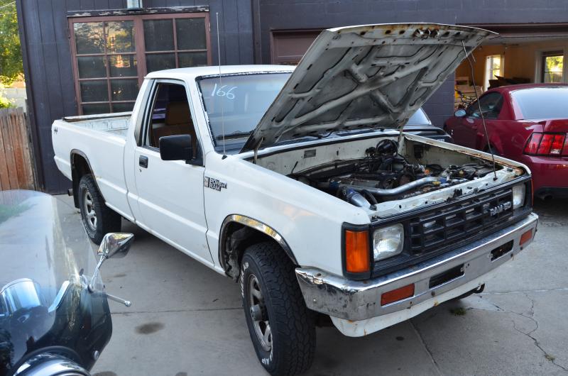

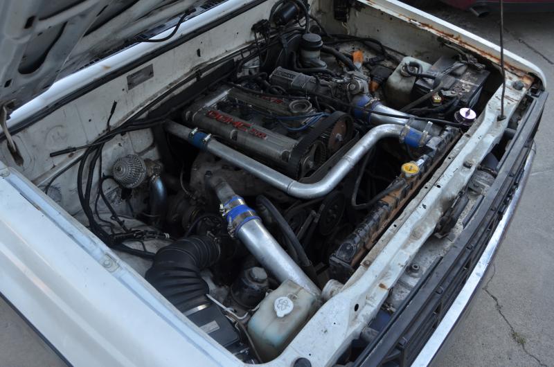

    Here are a few pics of the truck! I picked this bad boy up sometime last year and just got around to getting it running. Mods are the following..
    -Built 4g64 Wiseco pistons, Eagle rods
    -2.0 head
    -Ebay FMIC
    -Evo III 16g
    -HKS external WG
    -3" turbo back exhaust
    -Ecmlink V3
    -Evo 560 injectors
    -2g Maf
    -Hallman MBC
    -Bosch 044 inline pump
    -Comp stage 4 P.P.
    -Ceramic sprung 6 puck
    Oh geeze , that's a rusty one there. Though it sounds like you might have a few extra horses under the hood to blow some of that stuff off. Hide the stickers under the hood, there is one thing that cops luv and that is performance stickers. Oh just noticed also...no aftermarket cam sprockets? or did I miss that. That is also a DOHC, lol didn't see that on the list. WHAT??? no radio? lmao
    If that is a narrow block, let me know when your selling.
    06-27-2014
    18
    Murray Utah
    It's my shop truck, I'm not concerned about the stickers. It's a wide block, it has 2.4 cam gears.
