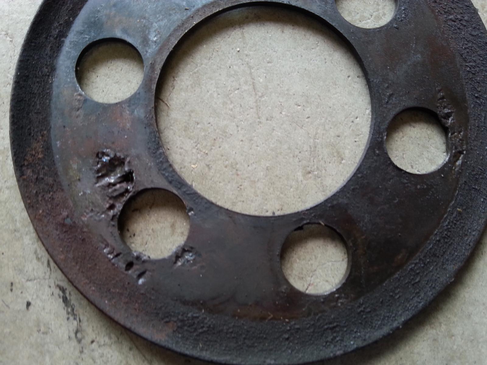

    How's this for messed up? Got the first torque converter bold out, rotate the crank around to get the the second and what do I see? Holy shit, that's a flex plate to crankshaft bolt loose in there... along with a big ass hole in the flexplate...

    So. The saga continues. Finally got the transmission off after we realized we had missed one bolt up at the very top. Duh.
    Damage from the loose bolt to torque converter. Surface damage only? Or worse. No idea...

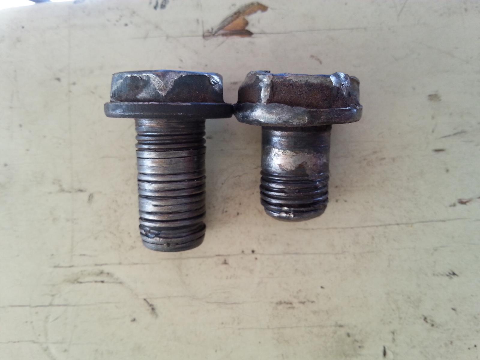

    Here you can see that another bolt was starting to work its way loose:
    Left - bolt that was coming loose. Right - bolt that was in between the flex plate and torque converter. Notice the threads on each
    Finally got the flex plate off... wow.
    Just wow...
    Close up of some of the damage

    End of the crankshaft. Notice the bolt stuck in the one? That's the leftovers of the bolt that was loose in between the flex and the torque converter. Gah.

    So now the next challenge will be:
    1) Getting the snapped off bolt out of the crank
    2) The two bolts that worked loose have bad threads inside the crank... retap?

    Oh that is nasty right there. Those are hardened bolts so I hope it hasn't messed up the threads badly. I'd try retapping the threads and hope for the best - or you're up for a new crank

    Wow!, What was the name of the stuff you were smokin when you put it back together? Gonga! My gawd that looks gnarly from the photos and must of made some hell of a noise before it stopped. Gotta think how much torque was applied to that flywheel to create a tear sideways on something like that. Incredible, wonder what hidden damage could of occurred on a hit with something so violent as that.
    Well, replace the broken parts, flywheel must be an exact match since they balance them things and I'm not sure if they balance to crank essembly or not. Using coil for threading should be fine since there are 5 other bolts to help. Sure hope you can torque to specs on the coil hole though. If not maybe a tiny lock tight if required to ensure it doesn't back out, which probably won't happen, IF YOU TIGHTEN IT!, lol.

    1980 Plymouth Arrow Truck
