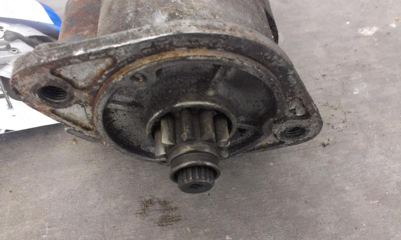

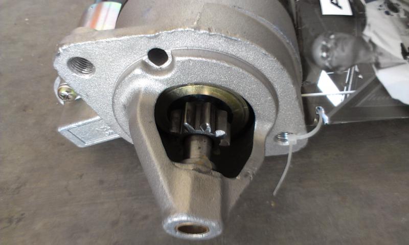

    Ok, so the new starter came in from Rock Auto... and it looks... different. Here is a pic of both.

    VERY interesting...the new one looks correct!
    1,271
    It actually looks like the old one is missing a cap or part on the end. It might be worth taking the transmission inspection plate off to see if this is so. Also, maybe look in the Hayne's manual to see if they have a picture on a typical starter. If that end IS missing a piece, the starter gears could push past the flywheel and not engage. As yours' is a 1st generation, I have no idea if the end lodges in the bell housing or not. But I strongly advise looking for any broken pieces from the old starter.
    It looks to me like the new one should align just fine.

    Interestingly enough, RockAuto also sells a Bosch starter that looks like my old one:
    Hmmm. I have never seen a Bosch starter motor fitted to any Mitsubishi engine - ever. Just plain weird...
    the starter without the nosepiece is from a starquest 2.6 - I have one from a parts conquest I diamantled years ago. same teeth count, just looks weird...
