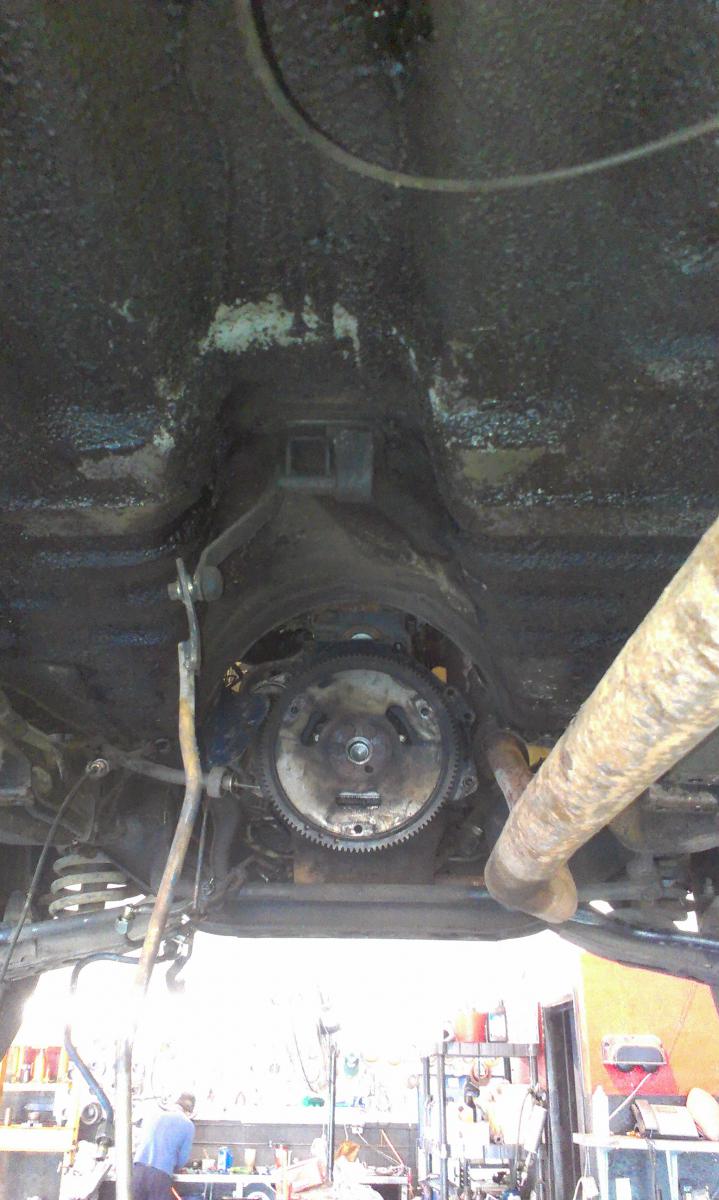

    Well, progress.
    Got it towed over to my brother's house in Phoenix, he has a nice shop behind his house.
    Got it up on jack stands, drained the transmission oil, exhaust taken off, driveshaft dropped. Going to have to order a new center support bearing, old one is trashed big time.
    Can see the flex plate now from under the truck, it is visibly cracked and warped.

    Some pics.
    Bad center bearing and new one.
    Also, crack in the flexplate:
