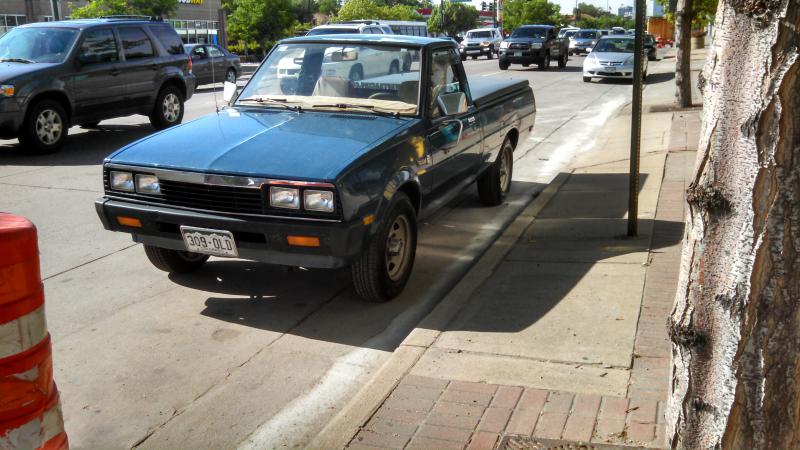

    Just a street side pic. More to come

    awwww man, good looking little truck.....you will be glad you kept it.
    Welcome to the MM/D-50 madness.
    Rust can do some heavy worrying on the brain, trust me, I been there done that. My little 84 D50 was the best 175 bux I spent in 1999.

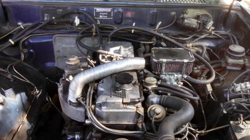

    Got one of the engine bay. I never "deleted" all that vacuum nonsense after swapping to the weber, just capped it off. I figure if for any reason I had to put the Mikuni back on or trick the emissions place it would be best to fake it.

    Welcome to the forum!
    I luv the the heat riser tube you got there, lol. Take that off it is just shoving hot air into your carb when it should be cool air if it can find it.
    Or point it away from carb or plug hole up.
    Best way to fool emission is connect all the smog back up to the weber since it does have auxilary inlets if needed and get an adapter for the weber carb to fit the stock air cleaner back on. That will hide the carb if emission station lifts the hood for a visual. You can also cut out the stock cleaner base with a templet made from carb top to fit the stock air cleaner and reconnect your heat riser if you want it.
    2,799
    Oh man, please get rid of that heat transfer duct - I am sure the air is already hot enough in the engine bay without trying to BBQ the side of the air filter straight off the exhaust manifold...

    Haha I did hack up my old air cleaner to fit the weber for emissions! I have that heat riser tube in for the winter... one day I was driving in a snow storm when my truck started spitting and sputtering like it was out of gas. When I pulled over there was a thick layer of ice on the carburetor!

    Err, o.k. Leave it there lololol. Damn it musta been cold...

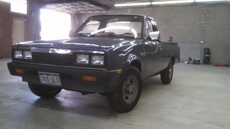

    Couldn't help myself. Moving into a warehouse at work and it was totally vacant.
