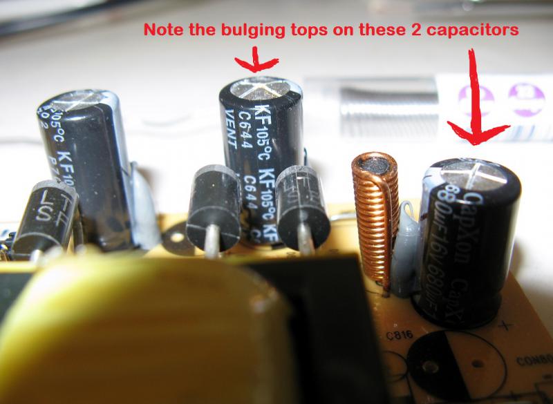

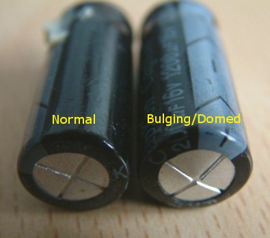

    Oh, as far as the undocumented code goes... If BradMPH is on the right track, and he very well might be, keep in mind I have head rumblings that the MM/D-50 has a history of ECMs having bad capacitors in them over several years. There is also the slight chance that your ECM is hinting at impending failure; the easiest way I've seen to check this is to physically remove the ECM from the vehicle, ground yourself to the casing of the ECM, and carefully open up the casing and check for failing capacitors.
    This check is very simple, most anyone can do this simply by looking at them. You're looking for shrink-wrapped metal canisters, which will usually be standing straight up. Check to see that the shrink wrapping (usually colored with numbers indicating capacitance and working voltage) is not burned, singed, or "pulling away" from the top of the component. Failing capacitors also tend to develop a bulge in the metal casing at the very top. Sometimes, the metal will rupture slightly. Once you have visually inspected the capacitors themselves, flip the circuit board over and look at the backside where the capacitors are soldered to the board. Sometimes you will see brown discoloration at the solder points; this is not necessarily proof of failure though.
    If the undocumented code is an addressing error (layman's terms: error writing/reading from the ECM and memory) that could either be a failing capacitor or failing ECM. I would venture a guess and say the issues you're having with the vehicle is the reason why it was traded in. It could also be a "ghost code," one that appears due to an error elsewhere in the system (possibly the wiring to/from the crank sensor, or the sensor itself). It's a rare occurrence, but I have seen it happen in GM cars.
    07-04-2014
    14
    Salem, CT
    1995 Mitsubishi Mighty Max
    Here are a few photos of bad capacitors I found doing a Google Image Search. Just so you know the types of damage to look for:

    08-11-2012
    1,190
    Richmond, CA
    Also any "electronic" or metallic smell indicates capacitor failure even if it looks like the caps are OK. The solder joints often develop microcracks invisible to the naked eye through years of heat cycles.
