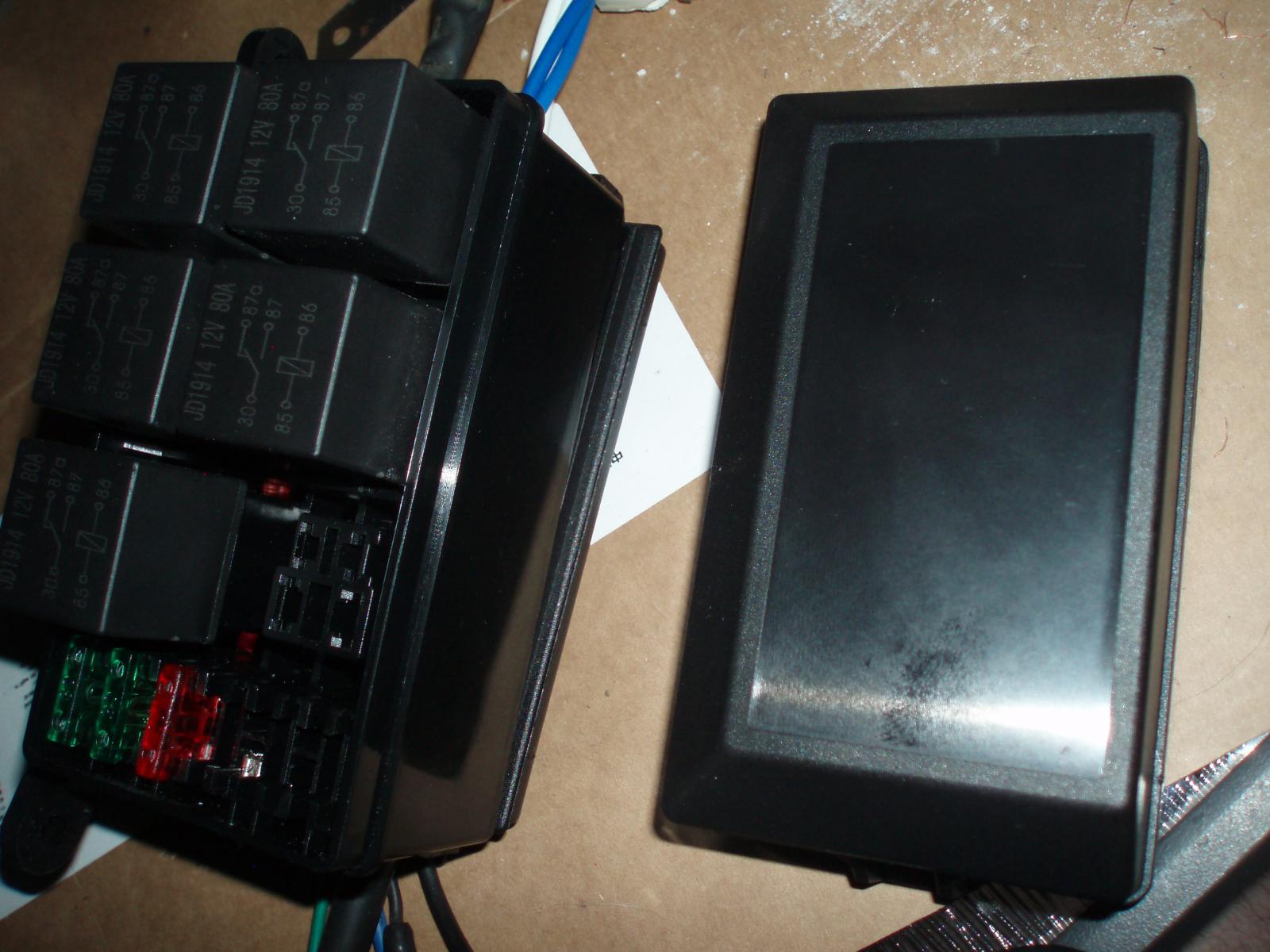

    At this point I've only installed the headlight harness (the rest of the relays are only dummied in there) I've split the harness for the A/C from the truck, chucked the old relays that were fitted to it and wired up the new relays that came with the relay block and mimicked the wiring pattern for the A/C fan and compressor layout. I didn't like the way the top cover was designed to sit on the block so I trimmed one locator tab and rotated the top cover so the bevelled edge faced into the engine bay instead. There is still a ton of wiring to do - I'm replacing all of the harness sockets (they've turned to chalk and the terminals are all corroded), taping it all back up and rerouting some of the wiring in the process.

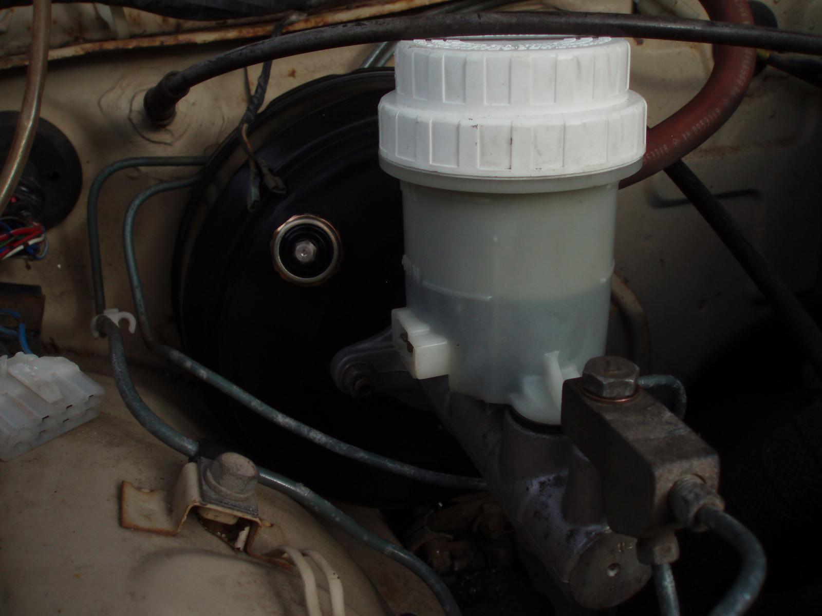

    And now, dem brakes -
    Booster is off a 2.8 TD. The master is from a Gen 3 or similar vintage Pajero
    My not so beautiful brake line reroute. You can see the brake fluid level socket in the side of the reservoir.
    The booster spacer is the same thickness as the original and allows clearance for everything on the firewall.
    The booster is close to the inner fender but not in any risk of being fouled by anything.

    geezer, your brake booster is on the wrong side of the truck..!
  16. #66
    So am I lol. It seems I'm always on the wrong side of this truck - I'm never 'in' it, either under it or hanging out of the engine bay. Winter is about to kick in hard here so I won't be doing much to it. I'll see if I can reassemble the Weber and have it waiting for install. It's one of those jobs that doesn't require me getting outside top do anything. I'm probably going to pull the entire dash out of it and remove the steering column/brake booster mount to do a mod to it (I am determined to fit a starter safety switch into the clutch pedal which requires a bigger retaining nut to be welded into the place where the pedal travel stop bolt is situated). I can give it a coat of paint too and tidy up some of the ghetto wiring that's hiding under there...

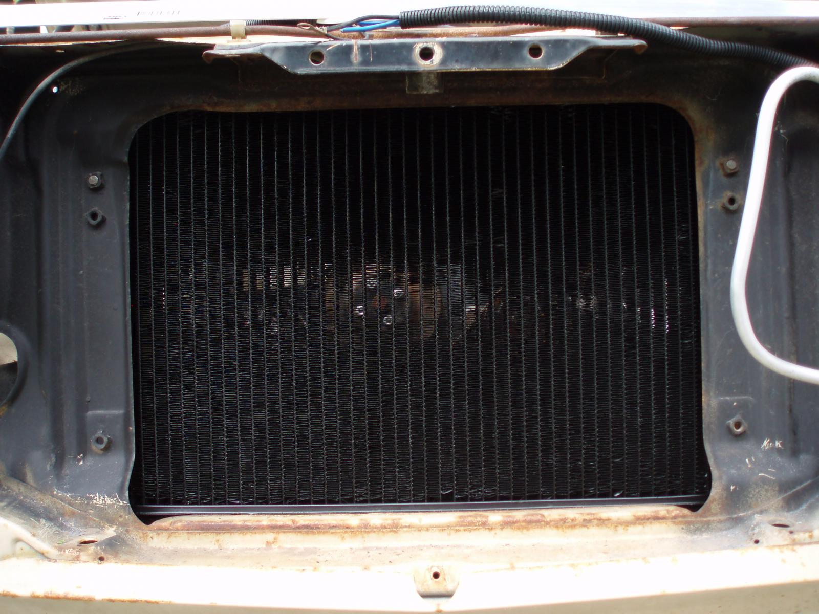

    Been a looong time since I've updated. Had not been able to find a viable used radiator for my Gen 1 anywhere and due to the AUD being toilet paper + morbidly expensive freight, I've not even thought about shipping one from ebay so I went on a field trip to my go-to yard in search of something that might be useful. I was close to trying a radiator out of an early Volvo (one that still had brass tanks and copper cores with a remote filler reservoir), then trawled though a bunch of different wrecks until I decided to go for a slightly harder target and try my luck with L300 vans. I lucked out on this path before when I found a brand new, unused radiator from a 90's van but the core height was way too tall to fit but I did spot one in an earlier model 2.0 that the core measured up to be the right size. If you've ever worked on a van engine bay, this is one sucky job to tackle. Me and the apprentice (my boy) started a fight with this thing that ended up with me taking half a litre of fouled coolant straight to the face before it finally gave up.
    In comparison, the 2.0 van radiator has the same size cores and the inlet/outlets are oriented the same but the mounting frames on the sides are completely different. The fact that it had coolant in it indicated that it hadn't rotted out and the cooling fins although a bit battered, were all intact - this purchase was out of desperation and I hadn't figured out how, who or where was going to be able to modify it for my needs. A search around via the net for shops locally that did repairs came up with 5 local shops - 3 of them had shut down and not edited the listings. Great... there was a shop not far from my dad's place that was still in business but the trick was will they do the mods and how badly was I going to get gouged for the privilege? It was a family owned business (tick this one as a positive) and after talking to the guy he assured me there were no problems with my instructions (second tick earned). So this is what it came down to - swap the mounting frames I'd already taken off my dead radiator onto the donor radiator and graft a thermofan sender bung into the bottom tank and pressure test the thing.
    He calls me 3 days later - "it's done, pick it up when you're ready. I had to replace the drain cock on it as the tap was chewed up - that'll be $70..." EPIC WIN (third tick of approval, awesome). Only thing I wasn't hot on was the acrylic spray can paint job but I planned on repainting it myself anyway.

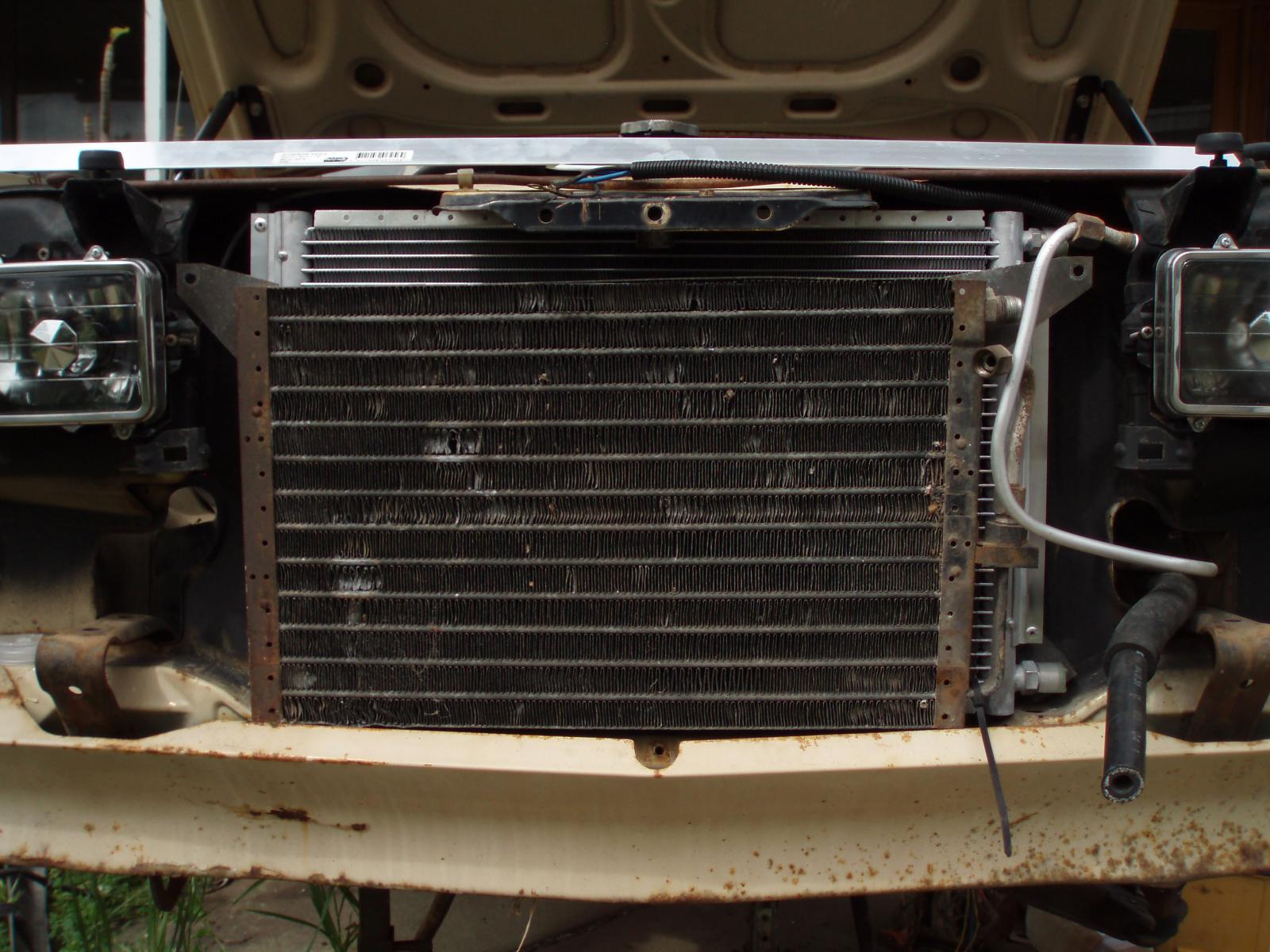

    image 1 - mocking up my new A/C condenser core.
    Ebay purchase listed as CNFP1421KT - 14" x 21" parallel flow condenser with dryer and fittings included. I decided bigger was better and I guesstimated that this would go in - barely...
    image 2 - the comparison in size of the old condenser vs new.

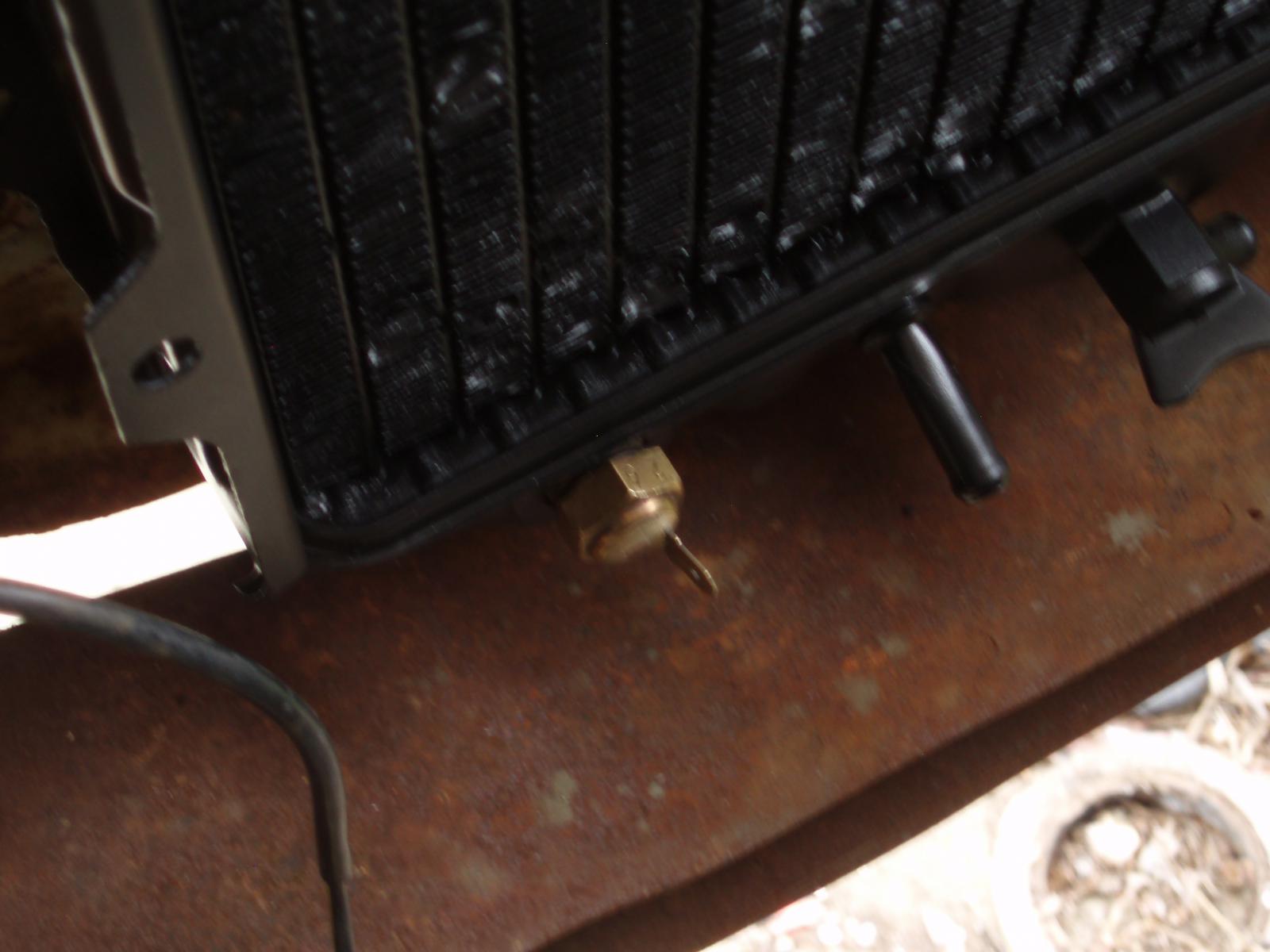

    image 3 - the single wire thermofan sender installed into the bottom tank of the donor radiator.

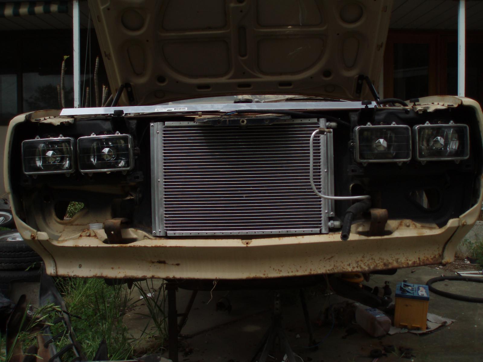

    image 4 - front view of the modded donor radiator installed.

    If you are considering installing an aftermarket A/C consenser for your Gen 1, a 13" x 18" will be easier to fit in there and won't require notching the upper core frame rail to clear the hood catch mechanism like I've had to for the 14" tall core assembly (yes, it is that tight I had to hack a section out of the top mounting frame rail...)
