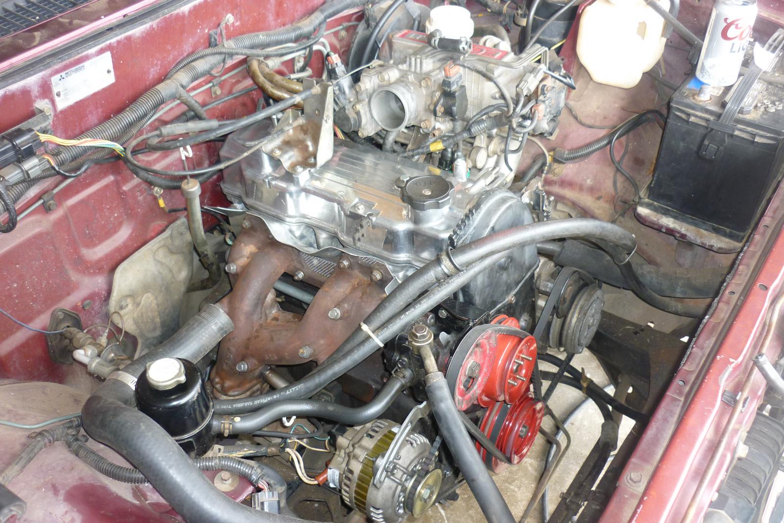

    Watching.......and wanting to know how you got the valve cover to look like that.....??????.....!

    Ground off all the rough casting around the edges, file finished the rocker gasket seat then sanding blocked the whole thing til all the faces were as flat as I could get them. Then I used a linishing block so the grain followed the same direction. Gave it a clean and hit it with a can of coloured lacquer. I was aiming for that 'extruded' look. A lot of work but it looked pretty good IMO. Click on my photobucket link in my post above (they're not in complete order but once you see a rocker cover image pre-painted the rest are sort of grouped together)

    Thanks man. I did do some polishing on mine, but I'm trying to come up with a color scheme.P1040977.jpg

    Shiny . Sort of job you only want to do once. I've done the black ripple paint and the OTT polish before so I wanted to try something different and the coloured lacquer was out on sale at the time. Looks good mitchi!
