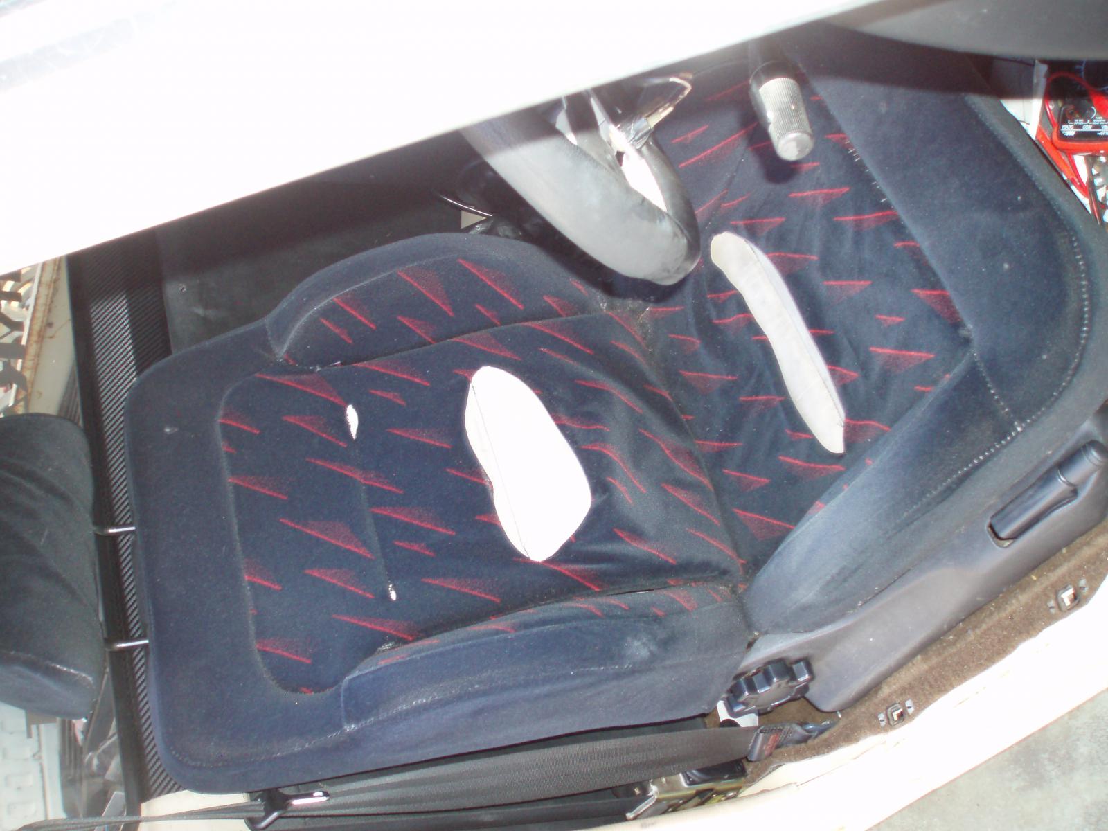

    Well, I grew to hate the seats out of the wreck. They are grey (does not look right in my all black sports themed interior) and, although an improvement over the factory bucket seats, were pedestrian at best. So I scrounged around a U-pull-it and found some funky seats I liked the look and feel of. Unfortunately the seat skins are stitched directly to the bolstering which after years of butts sliding in and out of them has ripped (I'm gonna have a go at sorting this issue out)
    ...and now it doesn't want to rotate image. But anyway these are seats from a Peugeot 306 Xsi. Picked up the pair for $99 AU and collected the seat belts with them so I could delete the floor mounted buckles. They are a little wider than the other seats but they are pretty comfy and have decent side bolstering. I am also considering installing a seatbelt warning light into the centre console. A bit of monkeying around to bolt the rails down but no worse than the first donor seats.

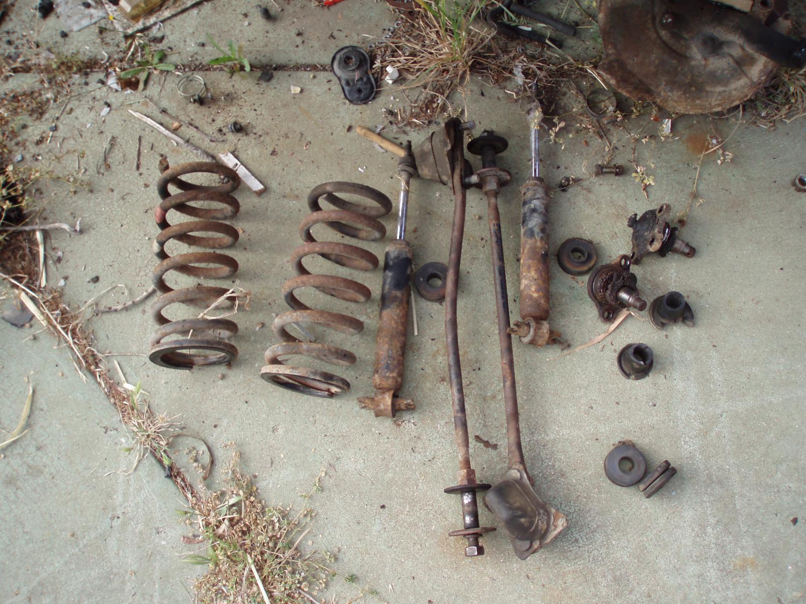

  16. #41
    My collection of 30 year old scrap metal...
    Mmmm, that radius rod look good don't it?

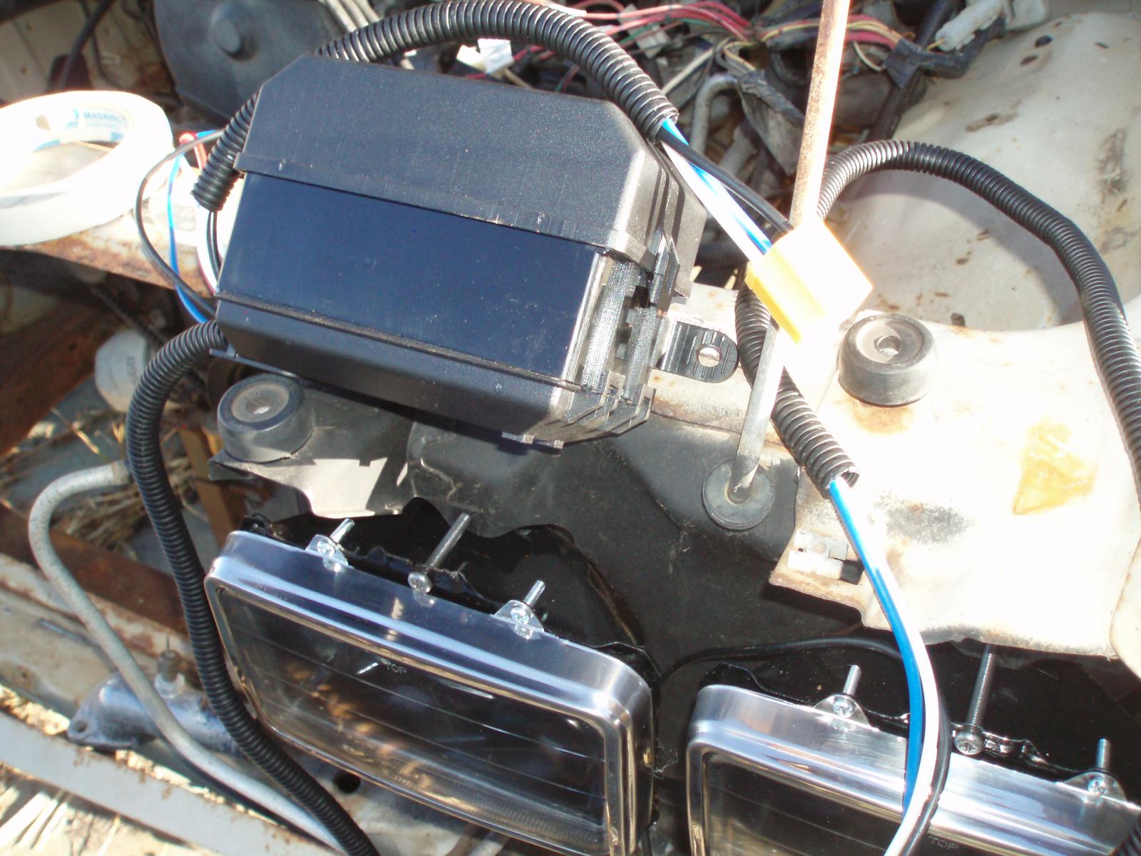

    So I've been hammering the electrics lately. Literally all of the connectors have perished so I bought a bulk kit of 30 harness plugs plus 3 rolls of electrical tape and started unwrapping the harness in the engine bay, cutting off the bad connectors and fixing the horrid efforts of owners gone by. I've needed a couple of oddball connectors like 6 and 8 pin connectors and had to buy them separately. The biggest change is the addition of a relay and fuse block next to the battery - and new headlight assemblies! I've modified the A/C wiring by locating the compressor and thermo fan relays into the relay block and converting the old glass style fuse to a regular ATO plastic blade fuse, and retrofitting a new ceramic socket headlight harness into the relay block as well (the good thing with the new headlight harness is all I needed to do was free all of the spade terminals and clip them into the relay block body). I'm installing an electric thermo fan for the radiator so that has it's own relay and fuse circuit which leaves me with one slot for a 4 pin relay. I'm relocating the glass fuse that's bridged into the ignition relay (well, I think that's what it is ) into the relay block as I have no chance of finding glass fuses around and it'll tidy up the wiring.
    A work in progress -

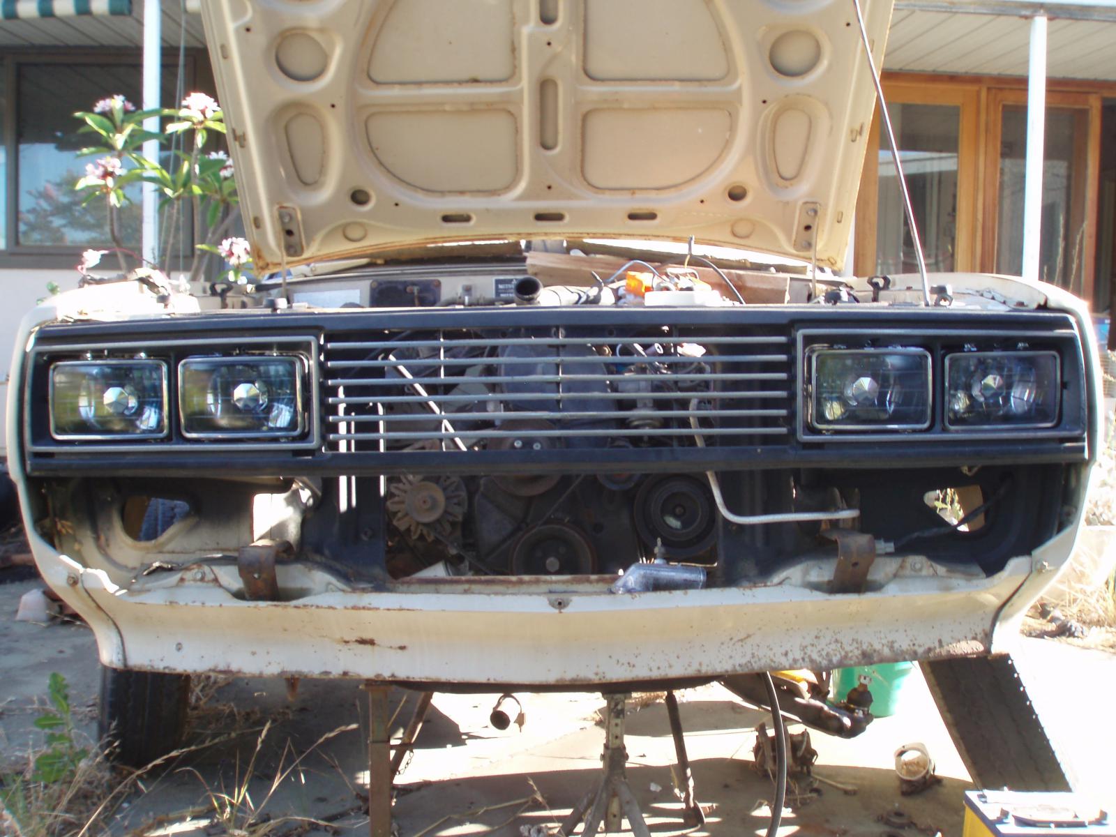

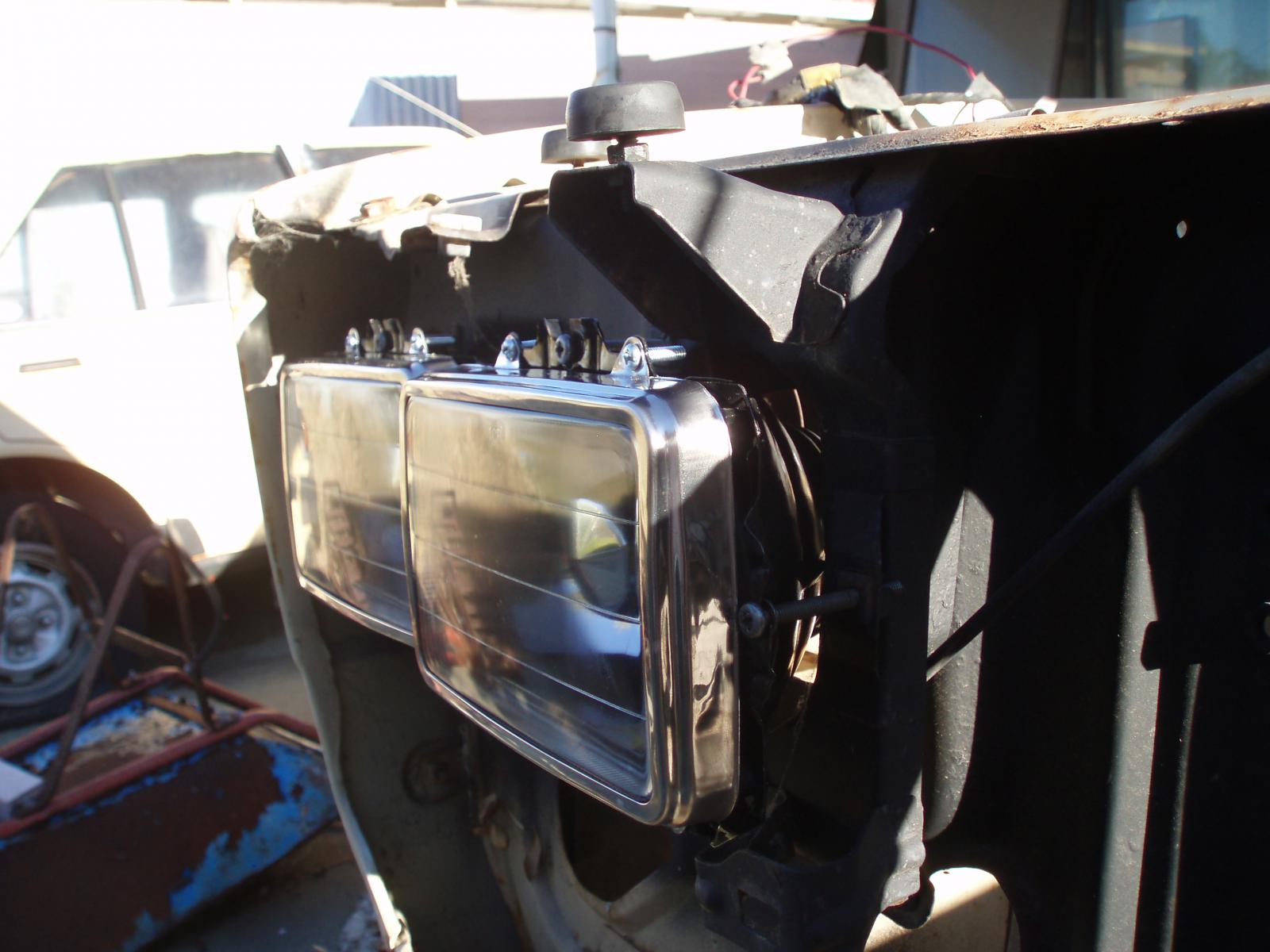

    Forgot to mention the headlights weren't a straight forward swap as the rear housings on the new H4 assemblies wouldn't pass through the headlight buckets and the locator 'feet' in the corners of the headlights were too tall and needed to be ground down a touch to make them fit. The washer bottle was not much more than a pile of crumbling cheese so I found a suitable replacement for cheaps from the magical land of ebay. The new headlight harness was supposed to be a 4 ceramic socket kit but it turned out to be only a 2 socket kit. This actually solved a problem for me as I wanted full function of all the headlights instead of the inners running high beam only. I'll have a second headlight switch controlling the inner headlights from another headlight harness which I can run from the factory harness wiring where I've cut off the redundant headlight plugs. I can add a fuse to the relay block and run power through it straight from the battery. Admittedly this whole process has made the wiring appear more complicated but it should take a load off the factory headlight circuit and make it more efficient. The added bonus is once I have it rigged up, I can undo one or 2 plugs and remove nearly all of the front harness with it's own relays and fuses in one hit - headlights, thermo fans, A/C and some of the engine wiring as well without having to remove the whole harness from the truck.

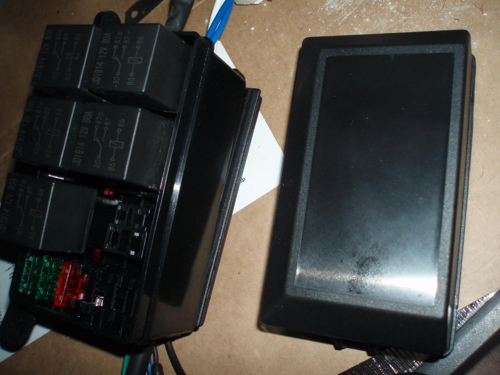

    I've been getting my bargain hound on and hitting ebay for replacement harness sockets, headlight wiring harness upgrades, gas hood struts, a 5" monitor with dual cameras and a 6 switch induction panel. So far the main focus of my work has been on the truck wiring. It had a dealership A/C fitted but all of the harness sockets had perished and the relays themselves were originally anchored to the engine bay frame channel and had broken apart. I've bundled them into an aftermarket relay block with an accessory headlight harness and the engine cooling thermofan so all of the systems are protected in one case.
