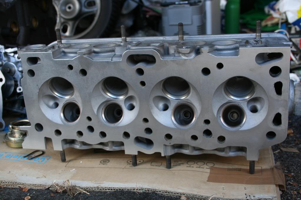

    ~insert super facepalm here~ Yeah, I know. This is one long winded process that has endured roadblock after roadblock, changes in direction and cash flow issues. If I could just 'throw cash at it' then this would be a done deal and I'd be motoring along by now nicely (but I ain't got no cash!). My head was trash and I wanted another mechanical head - couldn't get one. So I extensively reworked what I had (fingers crossed it pays off). Making it work required some serious port finishing that I couldn't afford so I used what I'd learned on previous engines and raised the level (plus the cam journal caps were shredded so I used one very dubious method to repair them ) .
    I could've left the EGR crap alone but I knew this would hinder getting it to run as smoothly as I wanted so I went the whole 9 and completely deleted it from the inlet manifold and sealed the EGR gallery in the head (I did a similar job on my G32B powered Celeste and it ran sooo much smoother) And then the carb. Previous idiot cleaned the base gasket it off it with the garage floor - yep, it's junk. This idiot buys a good clean Mikuni from a wrecker, then finds a Weber a few months later...

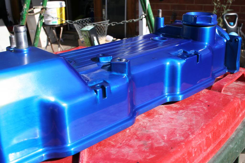

    Nice valve cover, Neil. Your articulate work and caring focus are very obvious in the photos.

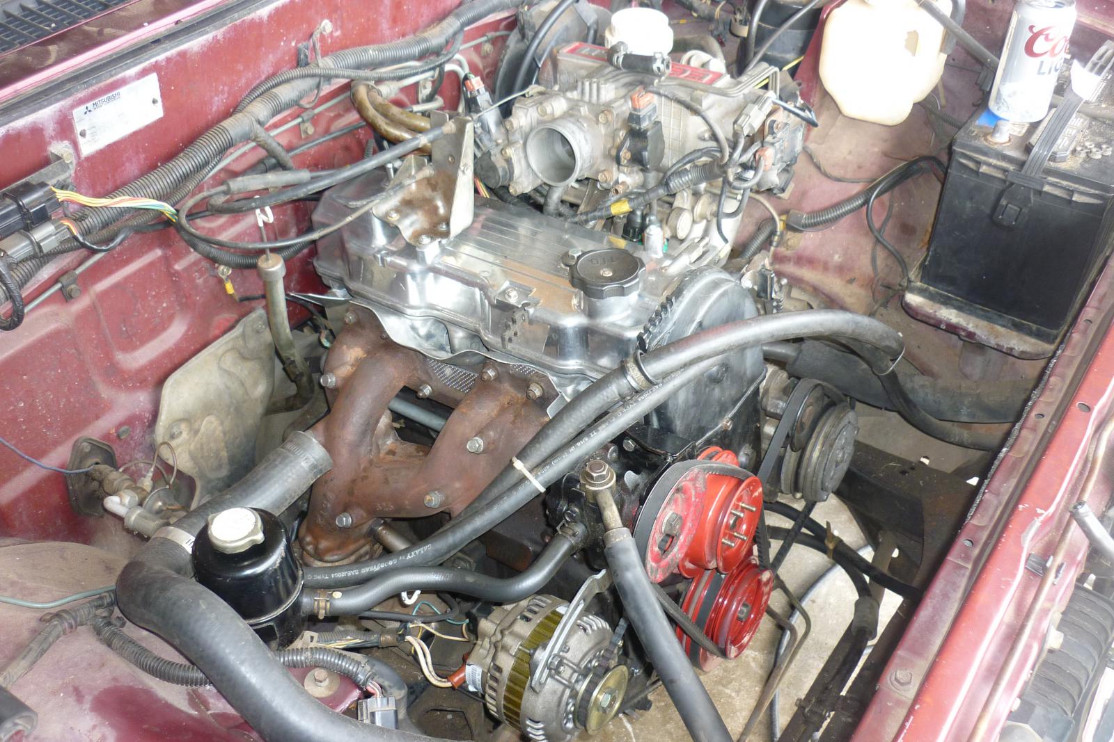

    Watching.......and wanting to know how you got the valve cover to look like that.....??????.....!
    Quote Originally Posted by mitchi View Post
    Ground off all the rough casting around the edges, file finished the rocker gasket seat then sanding blocked the whole thing til all the faces were as flat as I could get them. Then I used a linishing block so the grain followed the same direction. Gave it a clean and hit it with a can of coloured lacquer. I was aiming for that 'extruded' look. A lot of work but it looked pretty good IMO. Click on my photobucket link in my post above (they're not in complete order but once you see a rocker cover image pre-painted the rest are sort of grouped together)

    Thanks man. I did do some polishing on mine, but I'm trying to come up with a color scheme.P1040977.jpg
    Shiny . Sort of job you only want to do once. I've done the black ripple paint and the OTT polish before so I wanted to try something different and the coloured lacquer was out on sale at the time. Looks good mitchi!

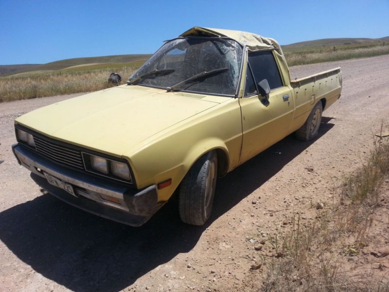

    Today, after a 5 hour round trip I brought home this -
    I felt that my truck had been off the road for far too long and was going to take more time and parts chasing than I was able to put into it. So I'll be scavenging a very healthy 4G63 and 5 speed out of it, near new steel off road wheels, headers and sports exhaust system, some reasonably good 3 way adjustable seats and anything else that survived the double roll over it had been put through. Come Xmas break and school holidays I'll be calling in favours and turning spanners. And hopefully I'll be able to do the upgrades I've been planning during the tear down...

    I'd love to have the air dam - not as much damage as you would think for a roll over - a new roof and straighten the doors. But then we can't see the other side...
    The cab is a mess - the ledge of the cab roof has folded over the tops of the doors leaving the passenger side door pinned down and the drivers door unable to close (which was lucky or I wouldn't be getting into or out of it without cutting it up). The passenger door is also folded in towards the inside of the cab, but I should be able to save all the freshly tinted glass which is in way better shape than mine. I actually drove it to make sure the drivetrain wasn't garbage and it's a shame it got rolled - it was nice and solid and the engine is quiet and smooth even with the sports system. I'll be breaking out the hydraulic trolley jack and timber bearers so I can at least get the passenger door open. There is something wrong with the carb as it is hesitant on throttle - the guy I bought it from did say he put a kit through it recently, but I'll get onto my 34 DATA carb and hopefully install that instead.
