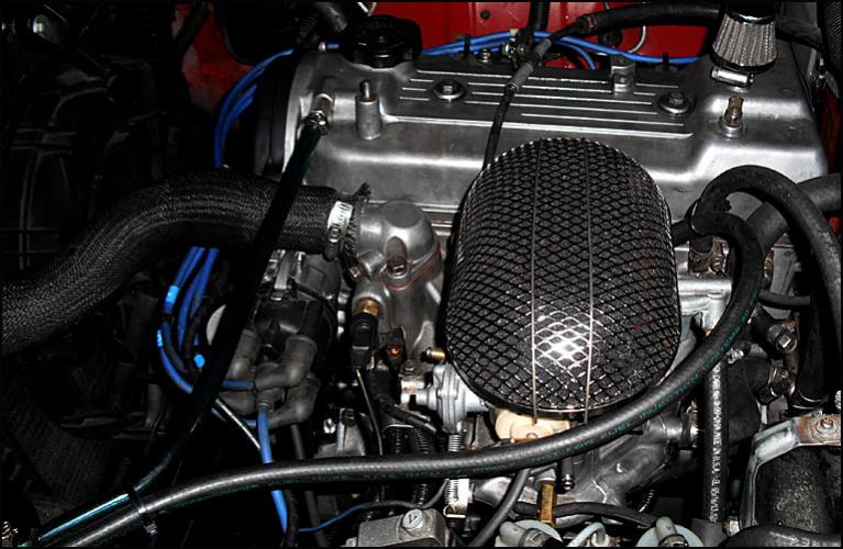

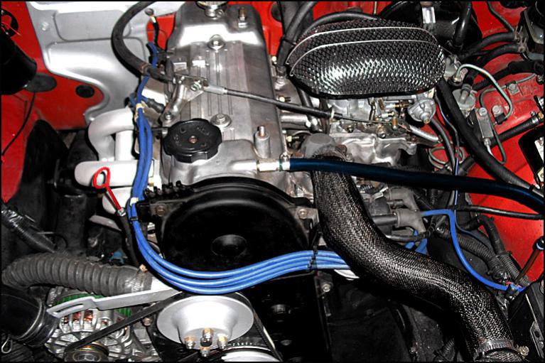

    I have one that has a piece that sticks up from the adaptor. The main problem with the rectangular filters that come with a Weber is that they are too short to let the carb breath. Geronimo has a 4inch tall oval filter assembly that let's the carb pull air straight in air does not like to make 270degree turns to get to the carb inlet.

    Just an observation here on this one. Using a directly exposed filter element like the rectangular K & N style things are a step backwards in performance. They improve throttle response but kill torque and also have the negative effect of drawing in the hot air from the surrounding engine bay. Some filters like the foam style element filters are barely capable of keeping out rocks and sticks (they shrink as they get older, plus if you're unfortunate enough to have a backfire through the carby it will roast the foam - causing charred chunks of foam to drop into the carby throats)
