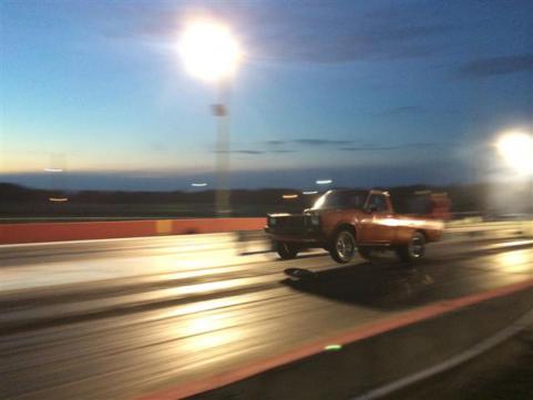

    I have a 1980 Dodge D50 that I drag race. I would like to lower the front of the truck about 1 inch. I was told if I cut a little off the coil spring to lower it , it would make the spring a little bit stiffer Is that correct?
