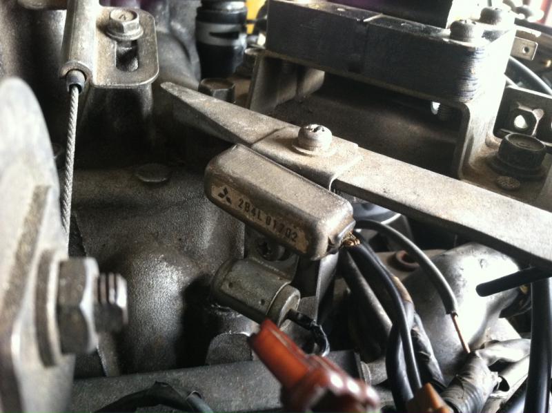

ID:	10281 Does anyone know what the part in this pic ( with the part number on it ) is? I've googledthe number and found nothing. I'll try and get it fromthe Mitsubishi dealer if nobody knows. Thanks...

    Thanks for the help, tried both websites though and came up with no match.
    3,620
    Looks like a resistor of some kind. Not sure. A regular test light won't work. It draws to much current. You could use a an analog meter. Then you can see the needle swing.
