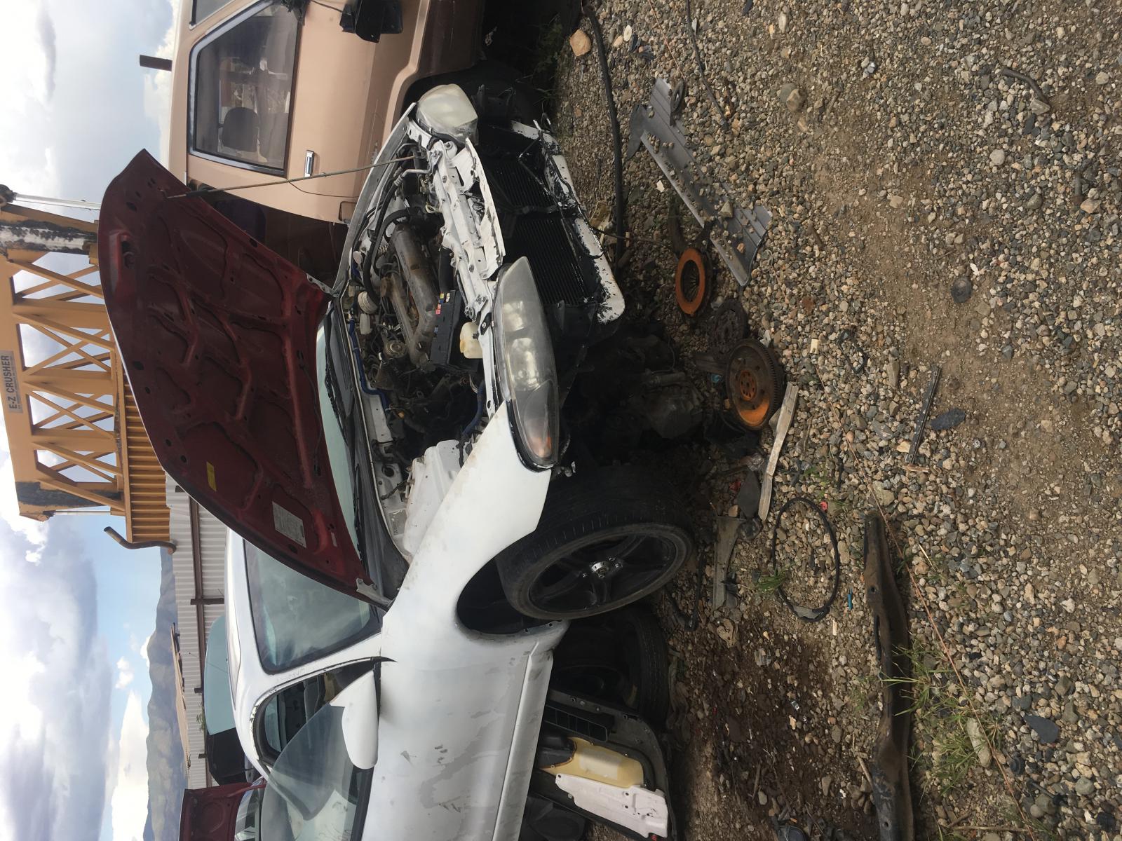

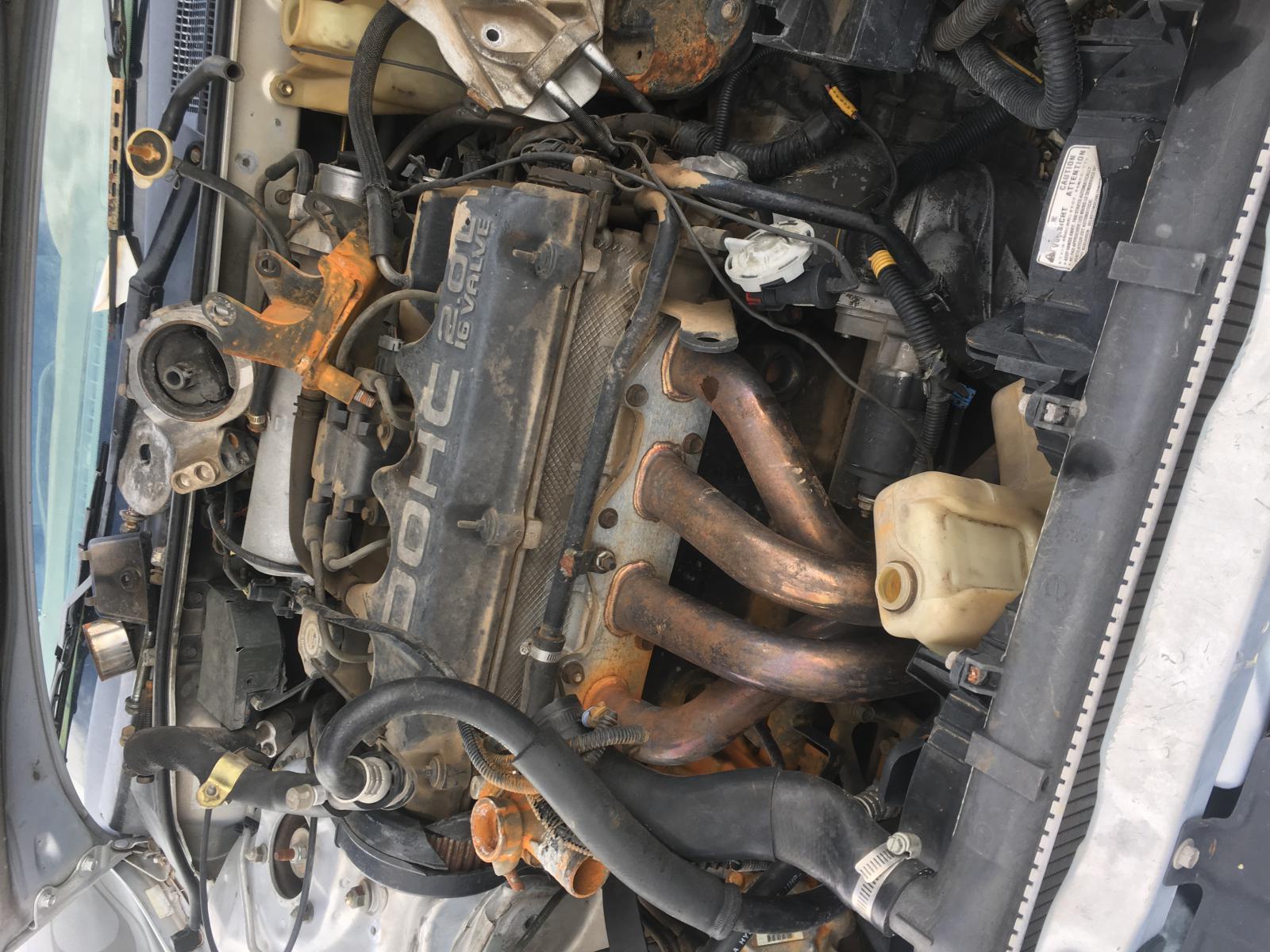

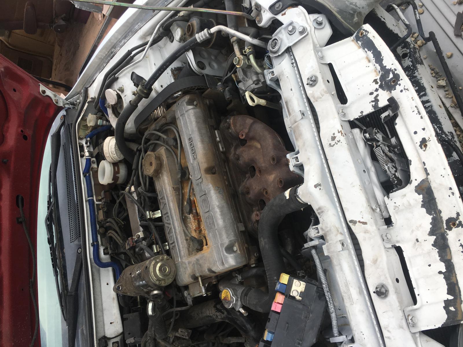

    Shortly after finding that I found a few eclipses. I am not familiar with the DSM, eclipse thing so I'll have to ask that you bear with me. Pictured below is the head that I am fairly certain I am going to need. I know it is a FWD variant and I'll have to move some things around but I just want to make sure I am getting the right baseline. I'd like to find a RWD head but I dont think thats gonna happen. Anyways, here is the head I think I am gonna pick up and the vehicle it came out of:

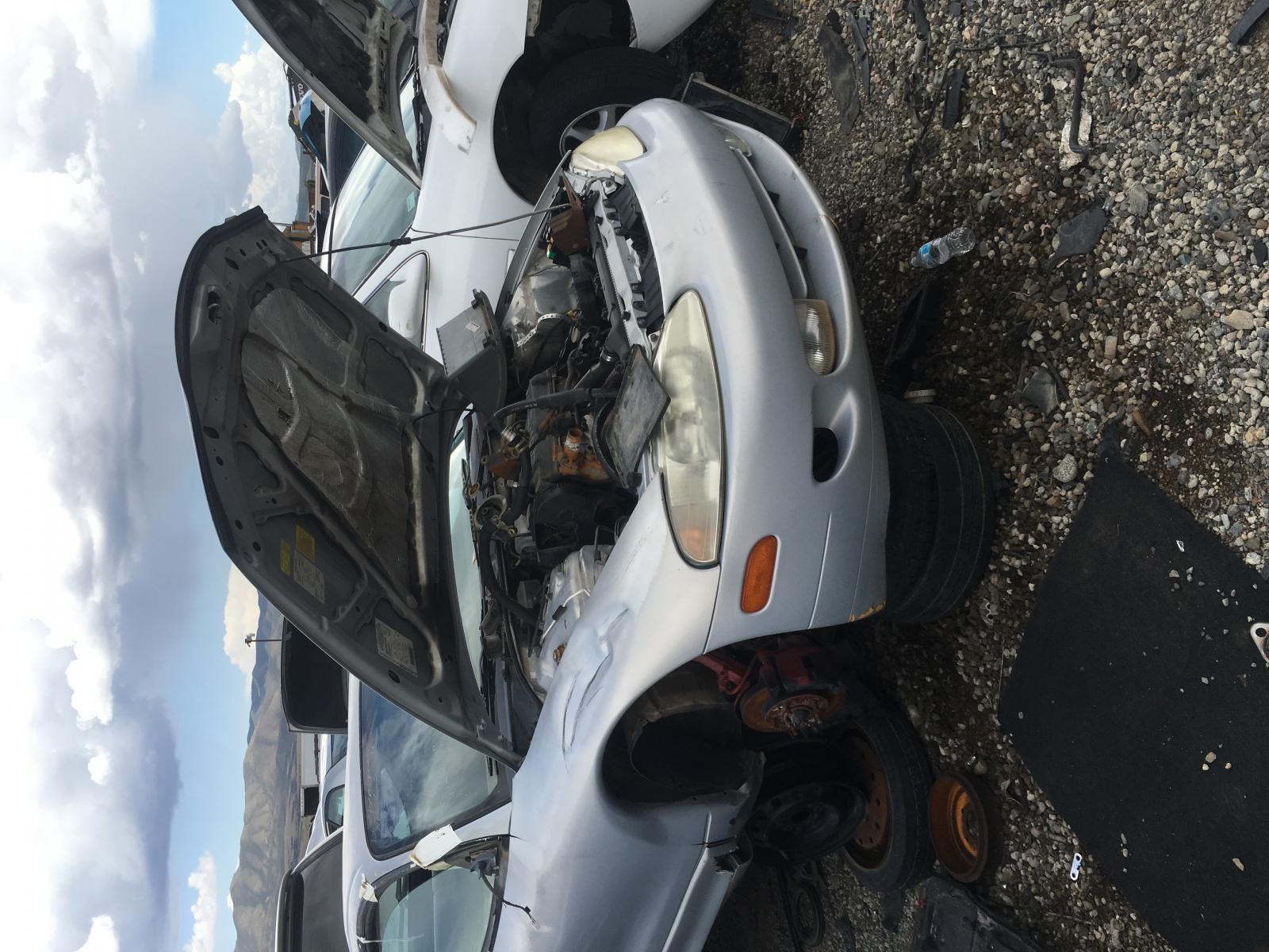

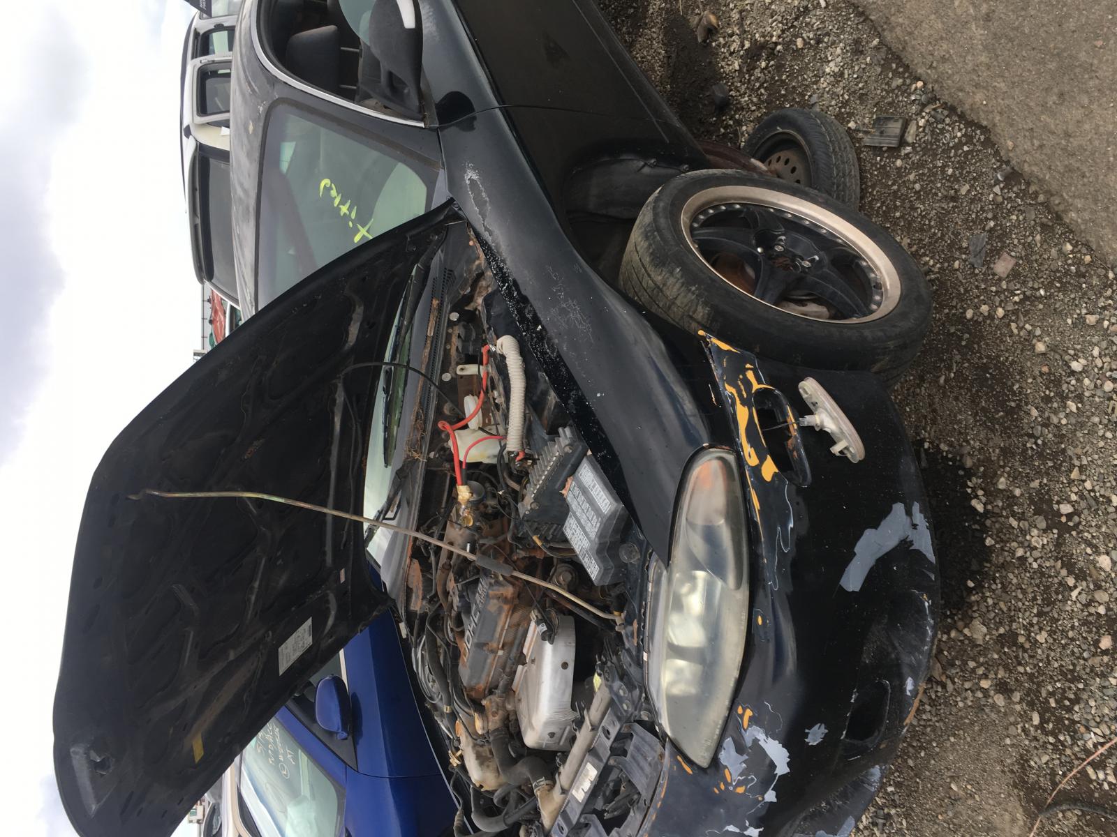

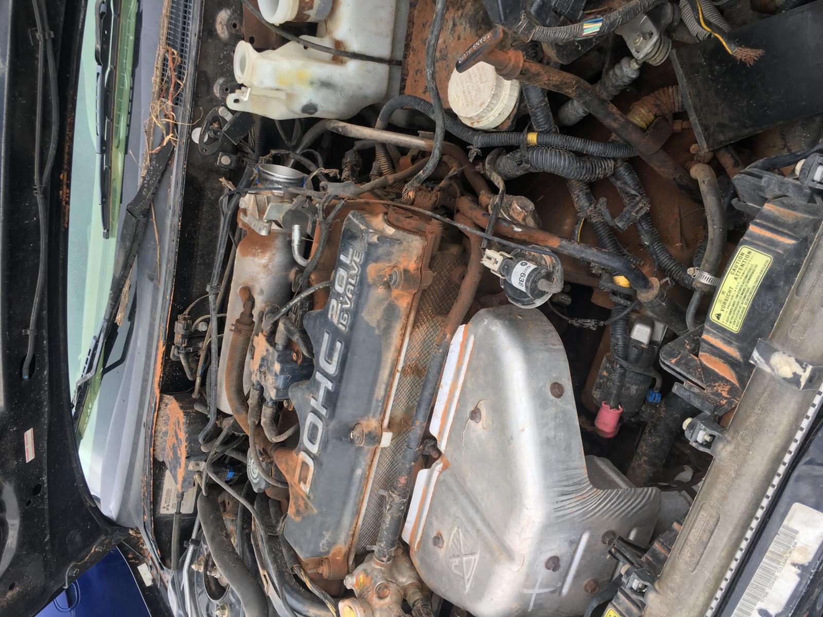

    I also saw these though as well. Like I said I am not familiar with these cars so this is what confused me. These look like essentially the same cars however the heads are completely different. Even if I don't use them, I'd like to learn the differences.

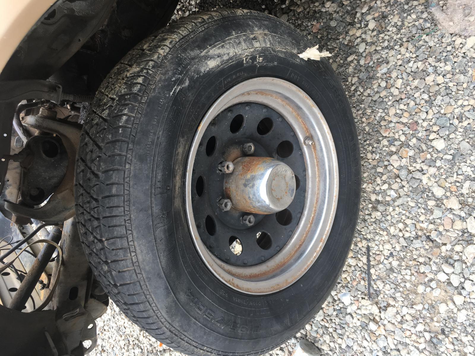

    Lastly, I found two sets of wheels, both on D50's that I actually really like. Full sets even. The only thing is they are 14's and not 15's. If i remember reading right the 4WD versions got 15's and 2wd got 14's. My question is, will 14s fit on a 4wd vehicle or was there something about it that needed the extra inch?

    There was a year change that the Eclipse drivetrain configurations were swapped. You need a 1G or 2G engine from a DSM for this swap. BTW there are no RWD 4G63 heads so you will need to mod the coolant routing and work around the CAS on the head. I've heard using an intake from a 4G64 Optima or Sonata will change which way the intake manifold is configured but I haven't personally confirmed that. I would've taken a rim off one of the 2WD trucks and tested it on a 4x4 to see if they had sufficient offset (one of the bonuses of going to a DIY yard is you can try before you buy). I test a couple of theories by doing this and it will also help fill in gaps where another part might need to substituted to get your idea to work (like the short hardlines I swapped when getting my twin piston brakes)
    14" wheels will not fit a 4x4 - they will interfere with the steering on the front, and the drums are bigger in the rear.
