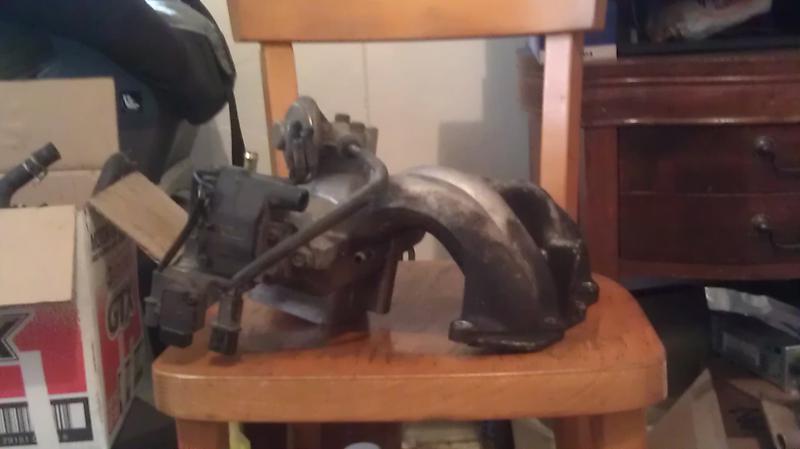

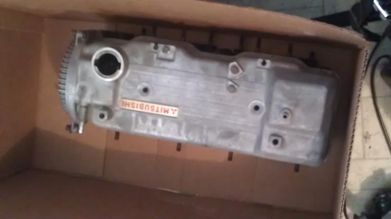

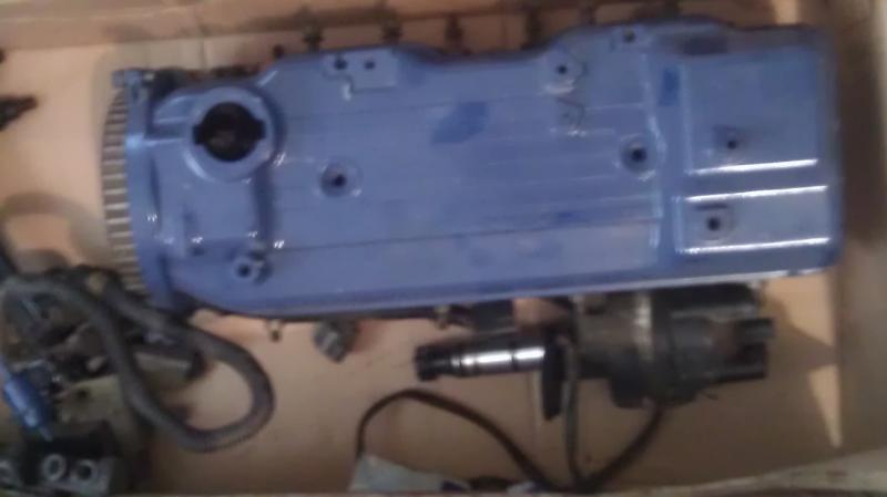

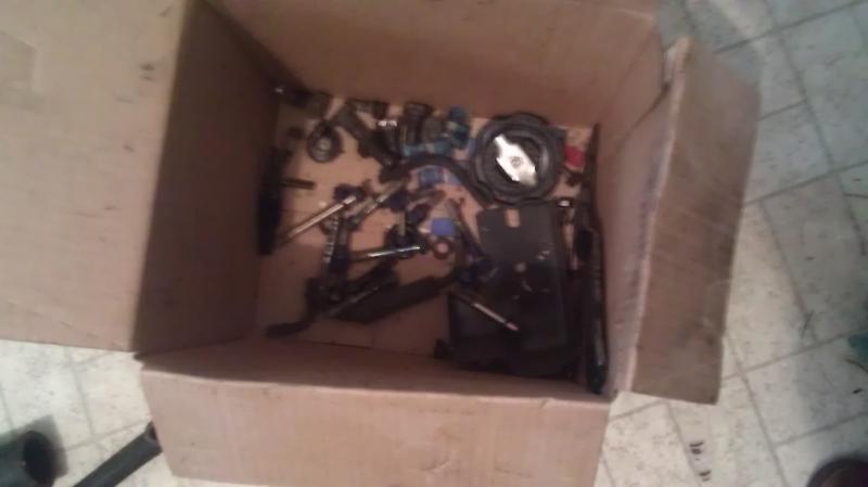

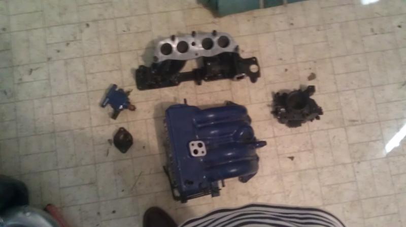

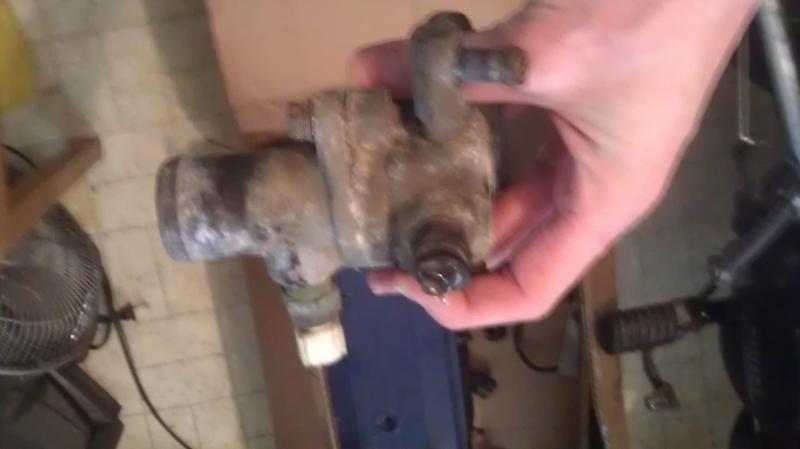

    04-09-2014
    33
    Carrollton, GA

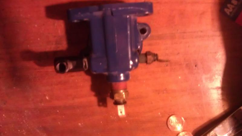

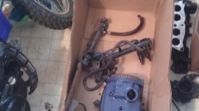

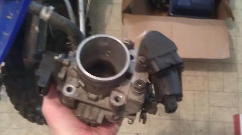

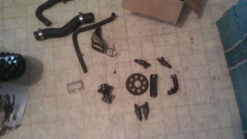

    All the painted stuff is off of a 90 2.4L the other is off a 93 or 94 2.4L2.4L 10.jpg2.4L 8.jpg2.4L 7.jpg2.4L 6.jpg2.4L 5.jpg2.4L 4.jpg2.4L 3.jpg2.4L 2.jpg2.4L 1.jpg2.4L 9.jpg The sad thing is I don't know what half of this is... I gotta meet up with the guy I got this stuff tomorrow as he forgot the other distributor and some other stuff.
    04-09-2014
    33
    Carrollton, GA
    I done some research and now know the majority of what I have. I meet up with the guy today and picked up the rest of the parts as well( extra dizzy starter and the complete Maf setup including all the hoses to connect everything.
