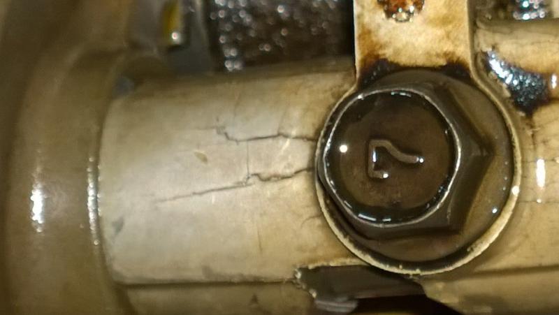

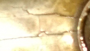

    i'm taking the head to a machine shop to get the broken exhaust manifold stud removed ... i noticed there are some cracks in the caps on the rocker arm assy that hold the camshaft in place. should i be worried about these? do i find them at junkyard?

    That looks like casting flash from when the parts were made/casted. Most likely those marks are just cosmetic from what I'm seeing in the pics.

    Make absolutely sure they ARE cracks, and not from when the aluminum was cast. A magnifying glass will help you determine this, also see if the "crack" cintinues on the opposite side. They might not be cracks at all.
    2,367
    They are casting flash. If cracks they would go right to where they would of started and that would be that hole where the bolt is. If you can't see them there then it's nothing to worry about. Mine has same thing and in more places.
    3,620
    Yep it's fine nothing to worry about..
