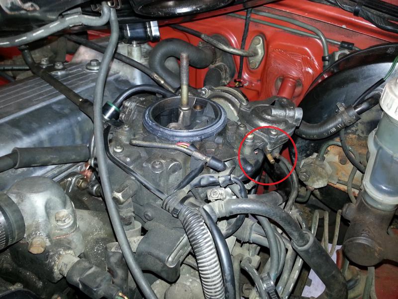

Ok, so after i rebuilt the engine and put everything together i found something that bothered me on my carb at the moment, i seemed to have either misplaced a vacuum hose or a stopper but can't seem to find the original item that went in place of it. Help would be greatly appreciated:

Also sometimes the manufacture post a sticker on under side of the hood with the hose routing and recalls that may of been performed.

Thanks fellas, I can't trust whats under the hood because its not the original hood. Now i just need to figure out this diagram.

The peg in question gets a cap. I replaced all vacuum caps and it runs much better now.
