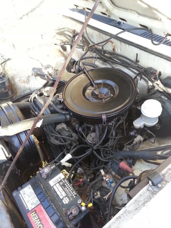

Ok Now for some pics!
Here are some before I started swapping and changing stuff:
Truck Front.jpgTruck Drivers Side.jpgTruck back.jpgTruck Passenger side.jpg20140319_183211.jpg20140319_183222.jpg
And here is the customary "Walk Around" after changing the Plugs, wires, Oil and Filter.
I will be taking Pics of the stuff I've changed and posting soon. I've just been lazy about it.
