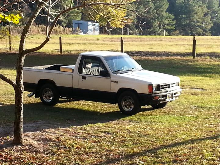

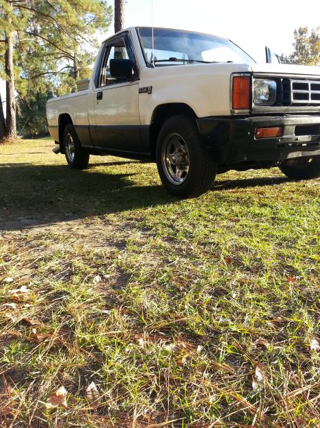

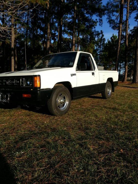

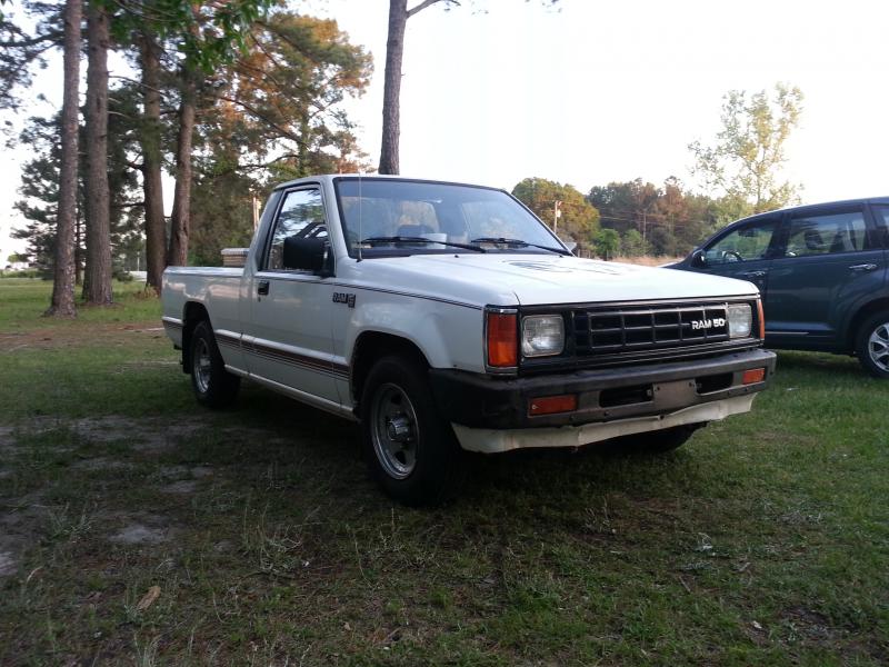

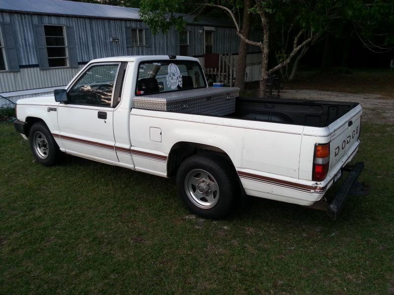

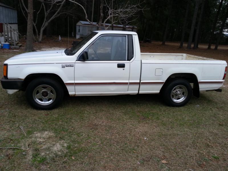

    Here are some before I started swapping and changing stuff:
    Truck Front.jpgTruck Drivers Side.jpgTruck back.jpgTruck Passenger side.jpg20140319_183211.jpg20140319_183222.jpg
    And here is the customary "Walk Around" after changing the Plugs, wires, Oil and Filter.
    I will be taking Pics of the stuff I've changed and posting soon. I've just been lazy about it.

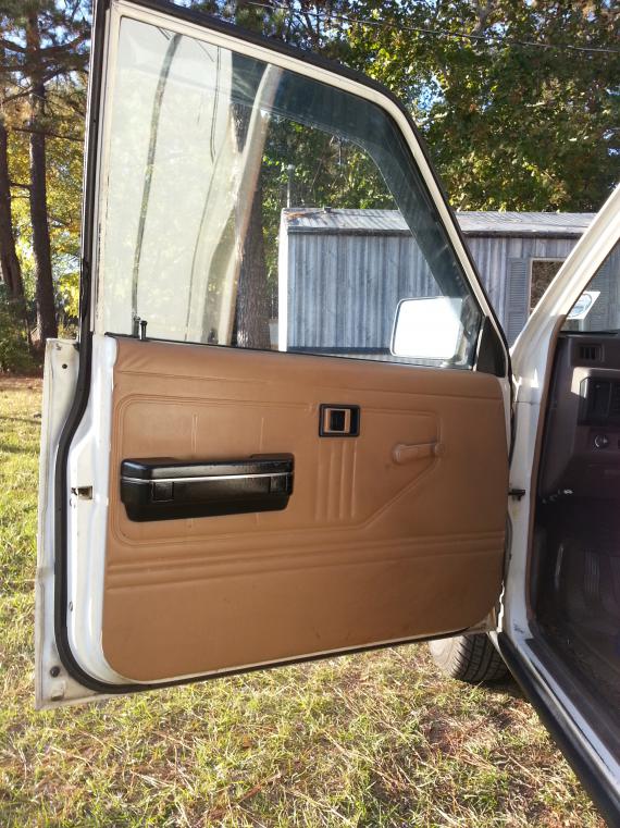

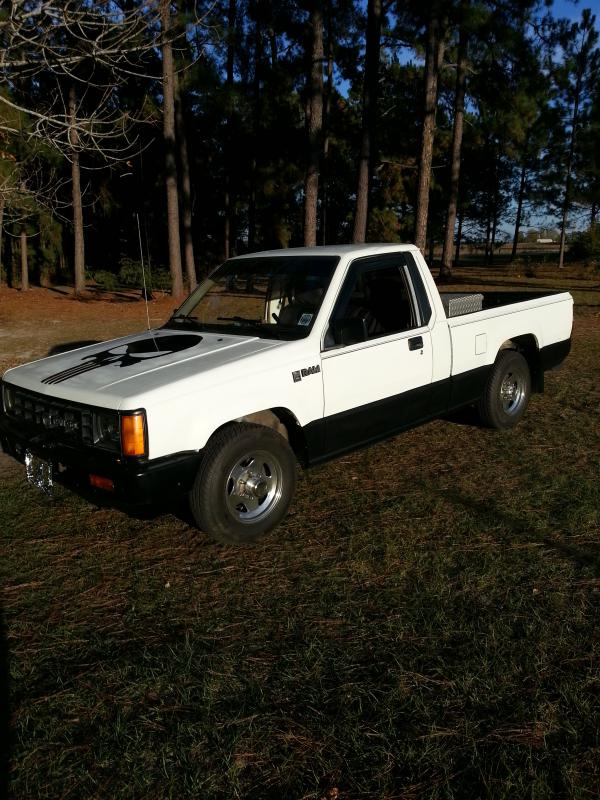

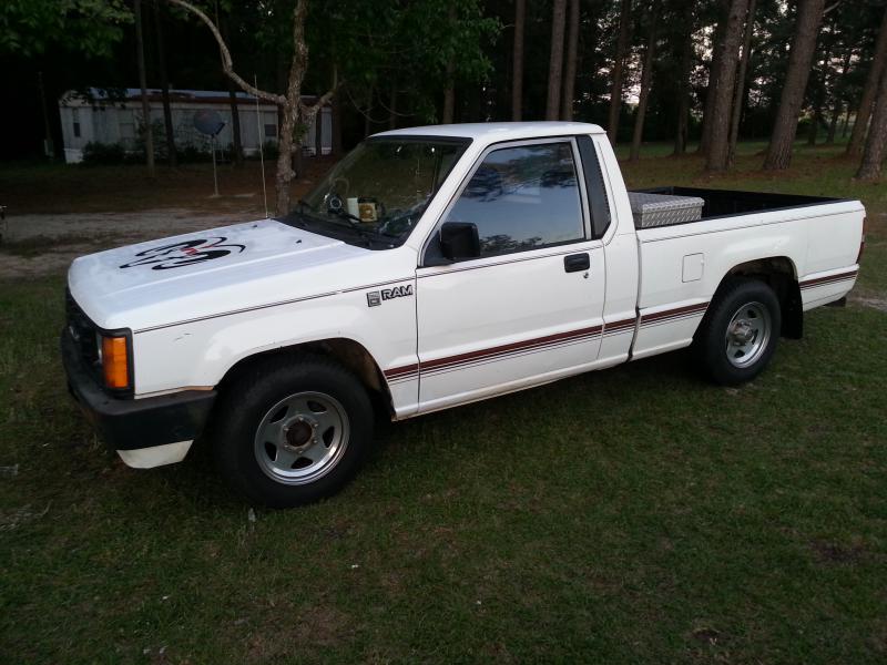

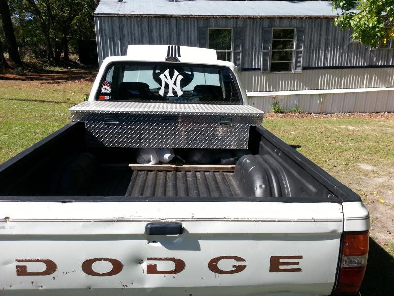

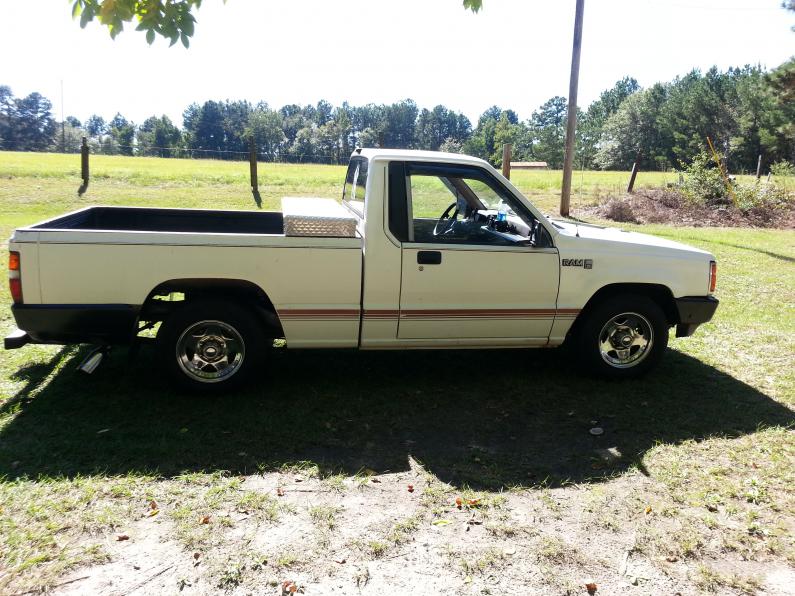

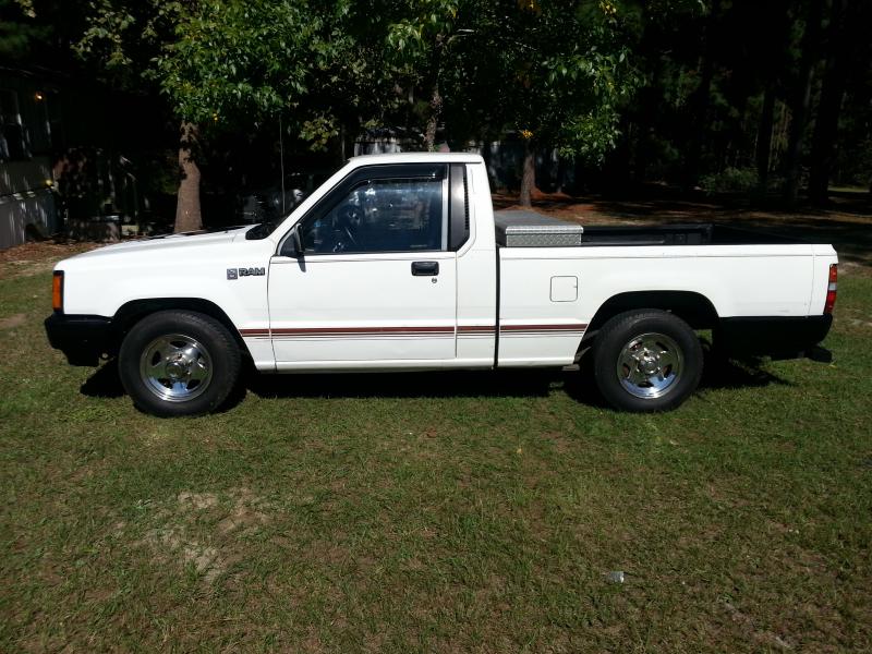

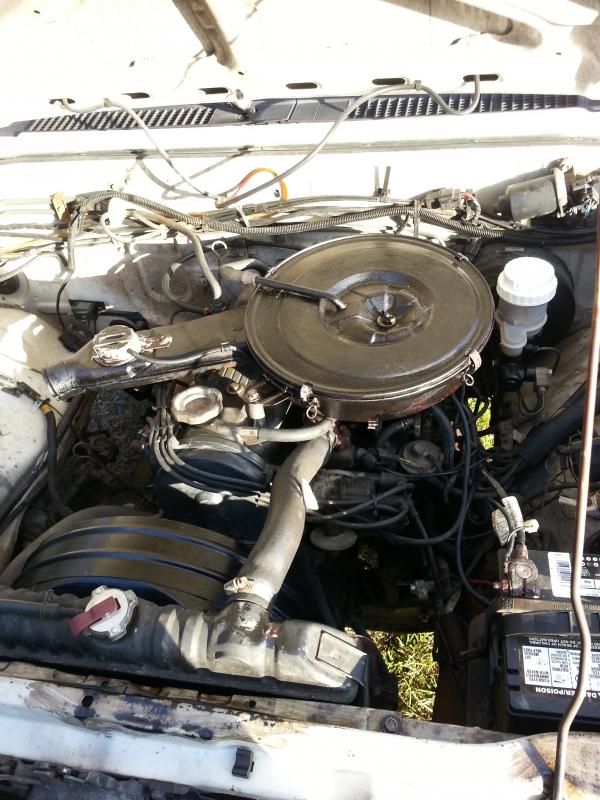

    Alrighty, Got some updated pic's of My D50 AKA Ragnarok!
    Stuff done in this round of upgrades.
    1. New Distibutor
    2. Updated the Air cleaner housing with Mopar orange paint job and Vinyl lettering. Added specter speed flex hose to connect the air cleaner to the air dam in behind the grill creating a semi cold air intake. (increase HP and better Fuel economy. 30MPG now after tuning carb and this and other additions!)
    3. Painted the front and rear bumpers
    4. Removed Catalytic converter. Welded in a straight pipe in its place (Also helped with HP and MPG)
    5. Got bored with the Ram/Mitsu hood decal. Replaced with Punisher decal. (Looks friggin Boss on Ragnarok!)
    6. Tinted back window and added sun strip on windshield.
    7. Got rid of the nasty/gnarly original Steering Wheel. Replaced with Grant Classic Muscle car style wheel (With Dodge Ram Horn Button!)
    At this point just waiting on my projector conversion lights so I can get rid of the crappy sealed beams and finally use updated bulbs.
    Gonna clean up the rest of the paint on the truck, and this should be it for me. Truck runs great and is looking friggin Boss. That was my goal for this Daily Driver.
    Engine 1.jpgEngine 2.jpgFront 1.jpgFront 2.jpgLeft .jpgRear.jpgRight 1.jpgRight 2.jpgS.Wheel 1.jpgS.Wheel 2.jpgS.Wheel 3.jpg
    1,273
    Truck cleaned up real good, Kaos...bet it feels great every time you drive it!
    Do you live on a golf course? Sure looks like you do with those greens looking that way.

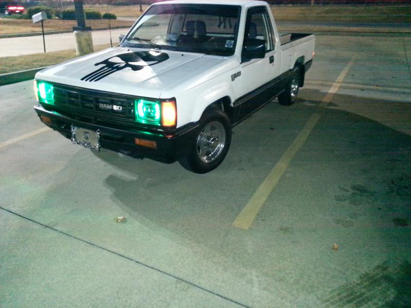

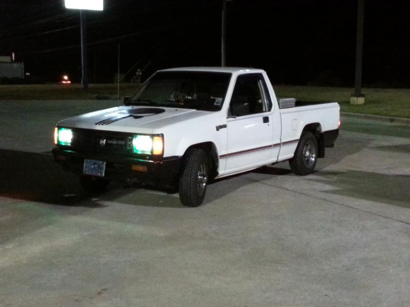

    Got the new lights installed. I'm diggin the Green LED's as the Halo ring. I might continue the theme with Green LED's for my instrument cluster in dash.
    1,273
    That IS a clean look, Kaos, and i like the offset Ram head on the grill.
    Totally unique and quite interesting!
    02-23-2014
    147
    Eastman, GA
    LOL You know you are the only person that saw the grill and "Noticed" the Ram insignia was an addition. Everyone else thought it was always there, like on all Rams... LMAO
