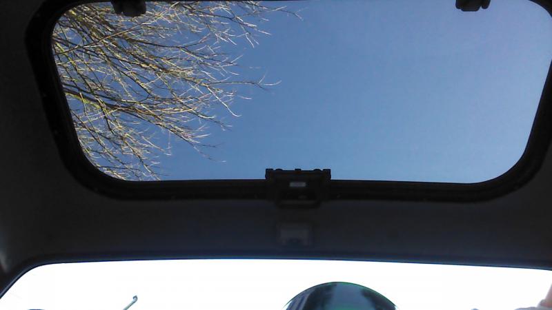

    This is what mine looks like looking up

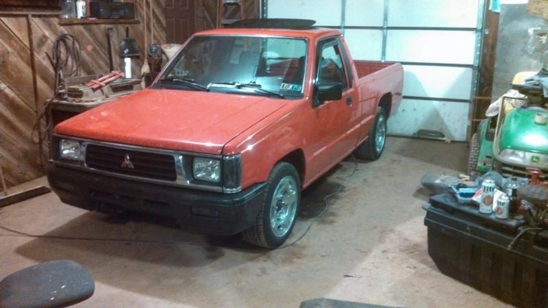

    OK guys so I know I said I was gonna do a writeup.... but there's really no need to. The kit is EXTREMELY simple. All you really need is common sense. Cut your hole where you want it And drop in the sunroof. That's pretty much it. The hole doesn't even need to be perfect because it seals from the top of the roof, not the edges of the hole. If you guys ever have any questions feel free to ask. Pictures to come of I can figure out how to upload them lol

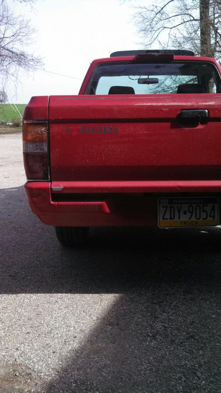

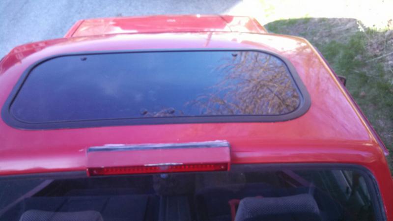

    ResizedImage_1398049255515.jpgResizedImage_1398049281402.jpgResizedImage_1398117879117.jpgIMG_20140421_180323_524.jpg
    Quote Originally Posted by bobbyk View Post
    I really wanna see a picture of the one you got. I'm thinking about ordering one. I believe that there is info on uploading pictures in the FAQ section.
    Heres some pictures of the finished product. Sorry if the pictures arent the best. Im no photographer.
