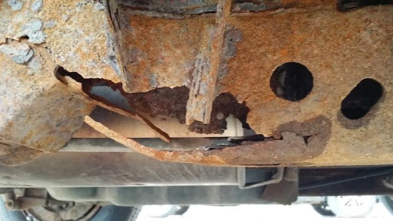

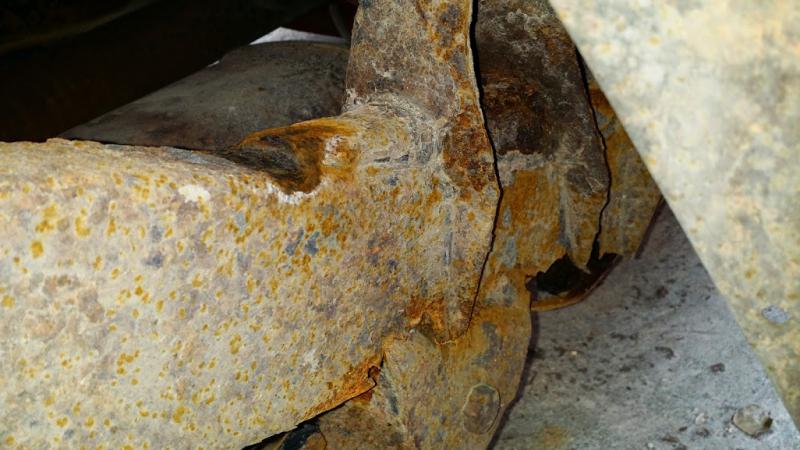

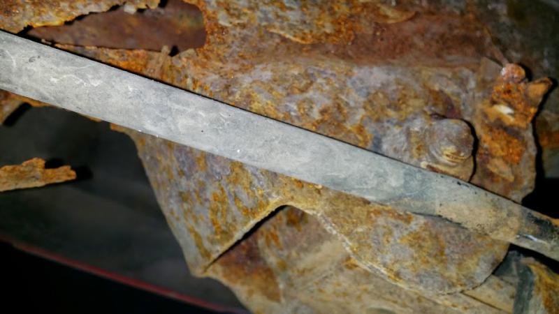

    Here you go folks.....you wanted pics and here they are!!!!20140414_181111.jpg20140414_181127.jpg20140414_181150.jpg These are the passenger and the worst of them.

    Yikes. Bust out the Sawzall and bag it with a 4 link.

    holy crap! depening on how bad the rest of the frame is i would just swap it out with the other one. then build what you want from there. if it got that bad the rest probably isn't too far behind.

    Salt, it melts the ice and the steel, what a great idea!
    these truck frame rot from the inside out - when I redid Geronimo we found what we thought was surface rust on the frame, until we sandblasted it and it was full of holesfrom the inside out. Went to weld in a plate with a MIG, and the frame opened up like a flower blooming - his frame is now from a 79 d-50 that was solid

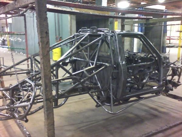

    Well you can't really go nuts with the tube. I already did that with my D50.

    Need more tubes

    definitely not enough tubes...
    More cowbell, ooops rolled hollow steel thingys. YouTubed You sure you didn't find that truck next to the Titanic and have it retrieved.
