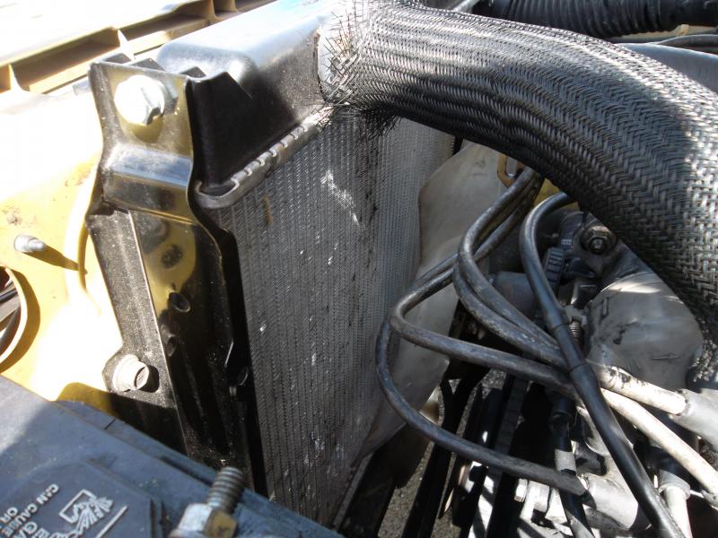

    I am a new owner of a 1980 Plymouth Arrow with a 2.6.
    I assume that when it was issued by the factory it had a radiator fan shroud? I have included a few photos below. Does this replacement radiator look stock? Will it accept the stock shroud?
    If anyone here has a shroud they'd be willing to part with, please let me know. My understanding is that these engines can be unforgiving in an overheat condition.
    Thanks!

    these trucks only had a fan shroud when they had A/C installed - you can get one from a 2nd gen Montero and they are metal which is better than the plastic ones used on the 1st gens with A/C

    i have a extra metal one from a 1989 mighty max if you need one. it'll be cheap.

    Last time I tried to use what I thought was a second gen radiator in a first gen, the hood would not close too tall. Can someone confirm this. First gen trucks are getting really tough to find radiators for unless it's a 2.0 which there are tons of. And I am not enthused with a plastic / aluminum radiator made in china at all.
