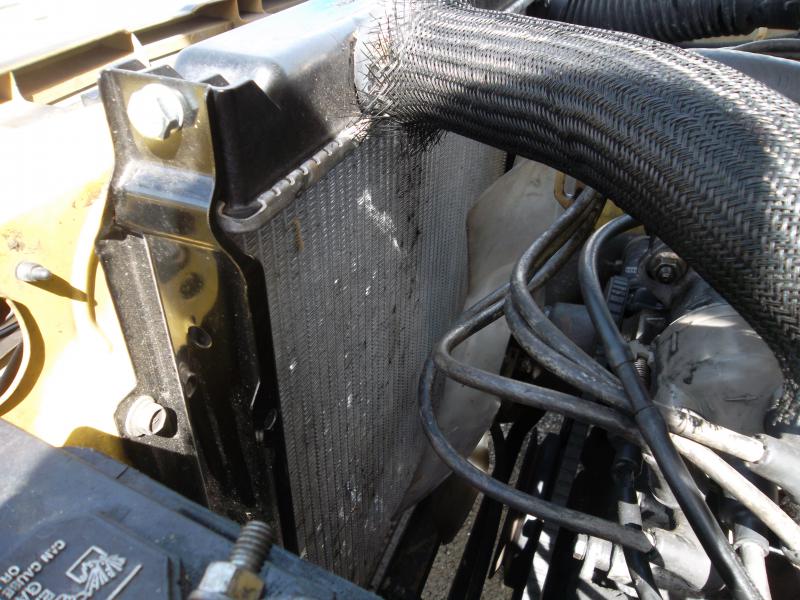

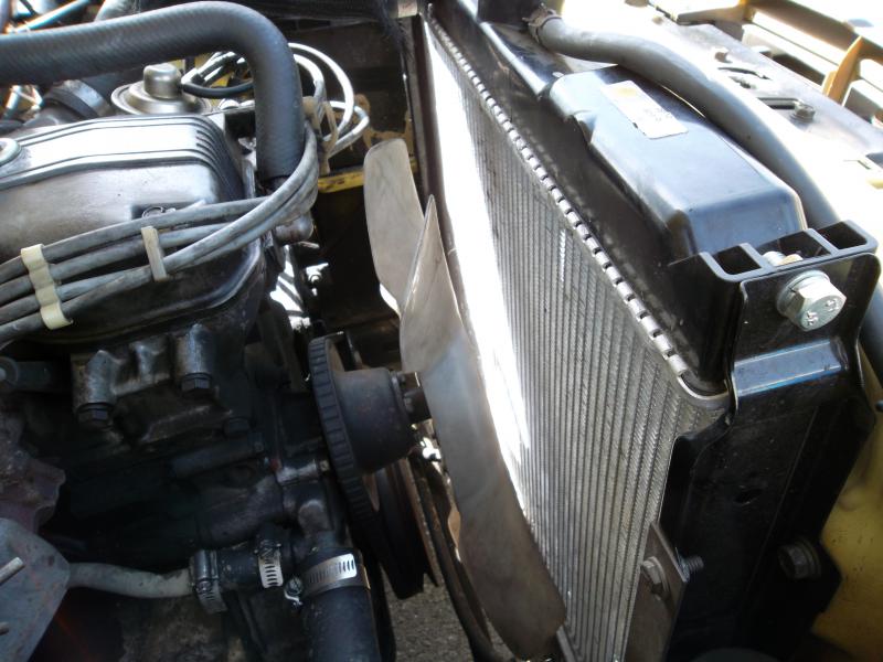

    I am a new owner of a 1980 Plymouth Arrow with a 2.6.
    I assume that when it was issued by the factory it had a radiator fan shroud? I have included a few photos below. Does this replacement radiator look stock? Will it accept the stock shroud?
    If anyone here has a shroud they'd be willing to part with, please let me know. My understanding is that these engines can be unforgiving in an overheat condition.
    Thanks!

    Nice radiator........................
    these trucks only had a fan shroud when they had A/C installed - you can get one from a 2nd gen Montero and they are metal which is better than the plastic ones used on the 1st gens with A/C
