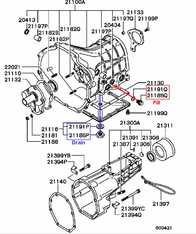

    Ok guys, I got all the materials together and I looked at it last night.
    I can easily see the drain bolt in the center of the tranny, but I'm not sure where the filler is.
    Anyone have a diagram or pictures? I don't want to pull the wrong part.

    Transmission Fill plug is on the Drivers side about in the middle of the body. best way is to drain the fluid, then remove the gear shifter (3 bolts) and measure and fill from there.
    2,367
    The filler plug is like Mike said on the side. If you like sitting under the truck pumping thick oil into trany, you could fill through the trany fill plug bolt. It's full when it begins to leak back out the fill hole as your putting it in. Same thing with rear end, It's full when it begins to leak back out at you through the fill hole.

    Thanks Brad, exactly what I needed.
    I already bough the pump so I'm just going to fill it through the filler instead of pulling the shifter. I'll let you guys know how it goes!
