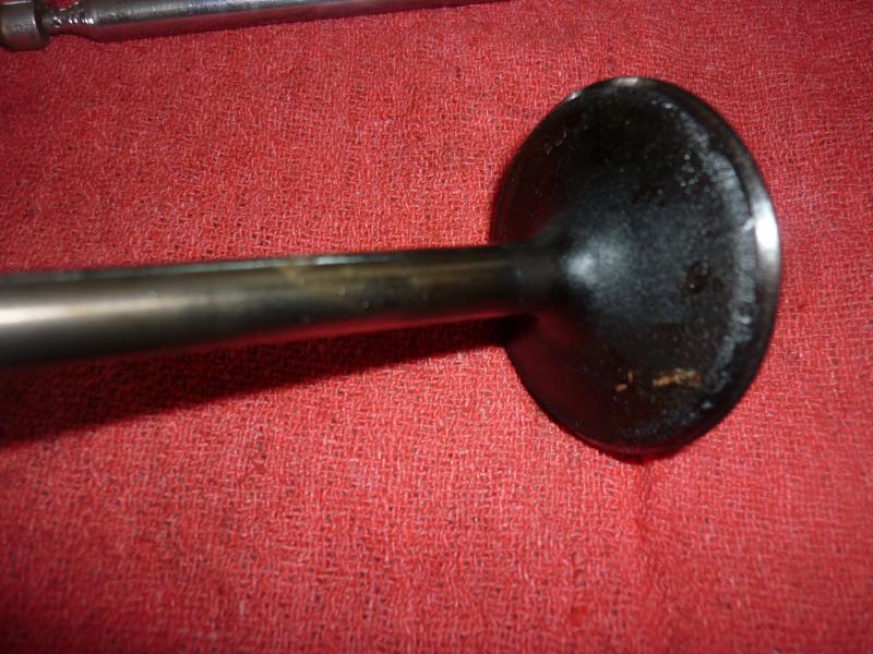

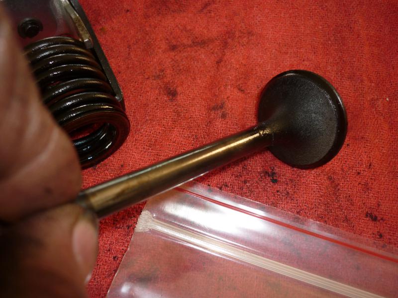

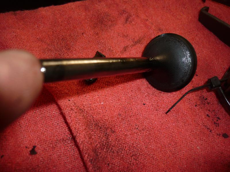

    And I 'm taking the valves out, should I keep track of which spring/valve/keeper goes to which place in the head?
    I think I found another problem.........will post a coupla pics 2morrow at work.
    Keep each assembly in seperate zip-lock sandwich bags. Mark the bags first with a permanent marker (cyl#1 int, cyl.#1 exh, etc). It'll obviously require 8 bags. You can't go wrong.
