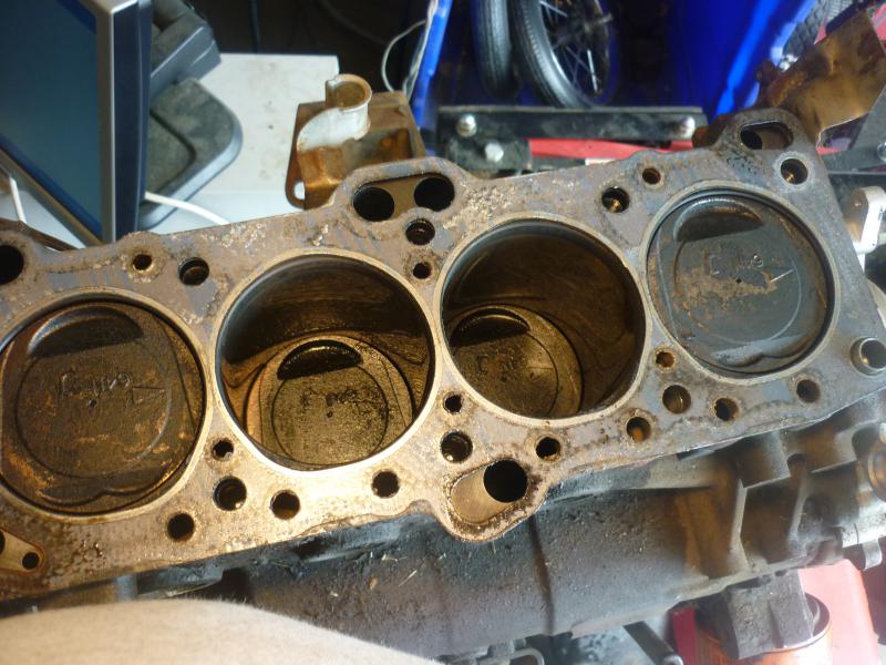

    I did do the test on the head, taking the cam out and having all the valves closed, and turned up. Filled the cavities with brake clean first and within a few hours all the cavities were empty, someone, I think my brother told me that was too thin of liquid, so I used 5w motor oil and that took several days and the #1 cavity was the one that leaked out.
    So I'm guessing I may have some valve issues, but, the stealership told me it was #2 cylinder that failed the leak down test, and I did have to pull #2 plug and clean it on occasion, to get it to run a very minute little bit better.
    Thanks for the advise, and I will pull that plenun out tonight and start cleaning it and the EGR valve.

    Check your cylinder walls for wobble scuffing. IN the photos It looks like I see some or it's the photo. Sometimes older engine will start to wobble the pistons a bit because of worn wrist pins. Though your head looks pretty decent and all look close to the same. Piston top edges look decent also, nothing too terribly different from others I have senn.
