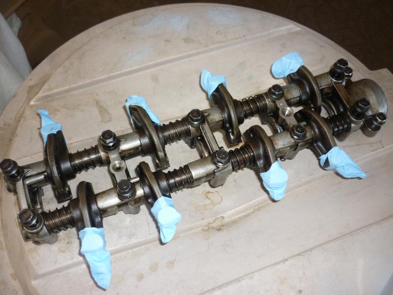

    Out of necessity, I kept the hydrolic lifters in place with mechanic's gloves fingers when re-installing the rockerarm assembly: it kept them from falling out and dropping down the oil passages. I highly recommend stuffing rags or otherwise blocking the oil passages while working on the head, to prevent bolts and stuff from accidentally dropping down. http://www.mightyram50.net/vbulletin...ll=1#post26624

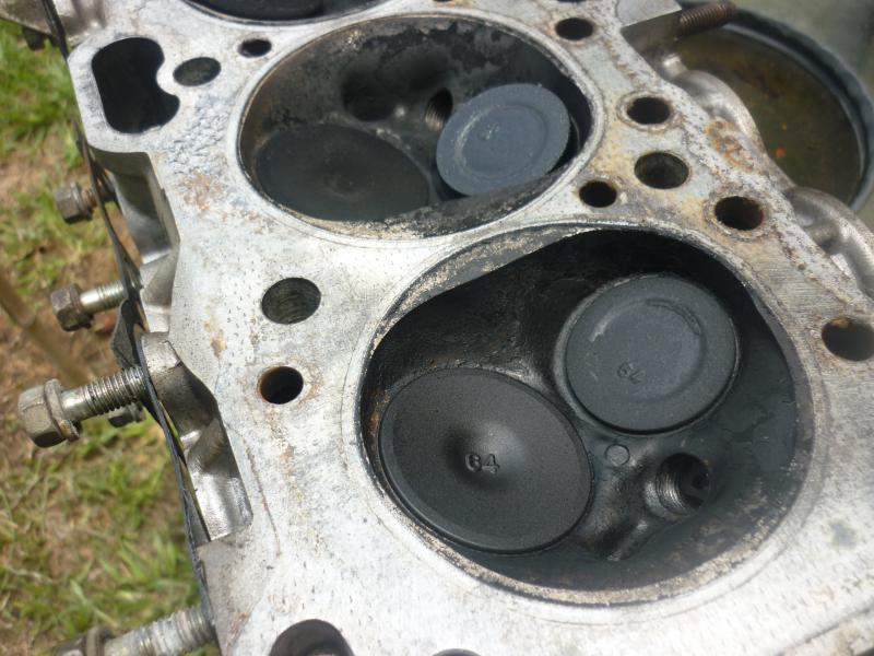

    I took pictures of the head with the cam out, and of the hole i think y'alls are talking about for the EGR valve.
    Man is that hole plugged. When I get to work tomorrow I'll post pics.

    Here's the head, that hole in the 3rd one looks blocked for sure.

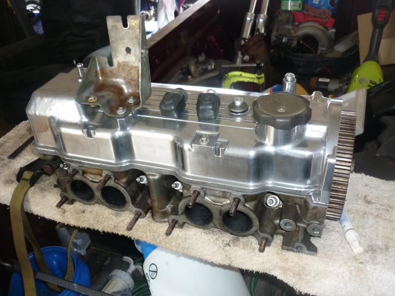

    P1040363.jpgP1040374.jpgP1040373.jpgP1040372.jpgP1040371.jpgP1040370.jpgP1040369.jpgP1040366.jpgP1040364.jpgP1040381.jpg
    1,273
    The work looks terrific, nice clean up on the valve cover. Glad to see the rockerarm condoms are of use to you.
    The Coors can next to the car keys is a bit omenous: watch out for that. The laws for DWI get stricter every year.
    Your intake (not of beer, but manifold) is very different from my 4G64, as it appears to be four individual pieces. But the rest is quite familiar. It also seems your EGR goes into cylinder #2, whereas mine is in #3. But there is no question a good part of Jimmy Hoffa is wedged in there...not that Jimmy Hoffa HAD any good parts, I'm jus' sayin'. I have to suppose there were, after all, some differences in the Dodge and Mitsubishi models.
    All loking good, Mitchi, and thanks for taking the time to post pictures.

    Oh look your rocker assembly is wearing little condoms. (now it's safe from Mr.Donuts)
    1,273
    Didn't you notice the vault in the background? They're preparing for safe sex.
