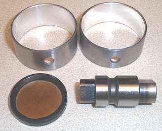

    Or get the $15 Mitsubishi OEM parts.
    Balance Shaft Eliminator Parts
    MD103722
    Balance shaft
    bearing, rear
    (pictured on left)
    MD040597
    Balance shaft
    bearing, front
    (pictured on right)
    MD092785
    Balance shaft
    cap (plug)
    MD098626
    Balance shaft
    stub shaft

    Mike, Where did you locate an OEM kit for balance shaft removal kit.
    Rockauto has them

    OEM parts are from a mitsubishi mirage. They didn't have the balance shafts.
