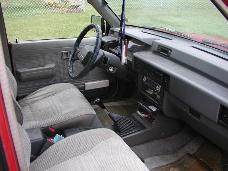

    Hi I just picked up a one owner 1989 ram 50 sport, 2.6L 4wd Manuel and inside is immaculate! Picked it up for a good deal cause it needs the clutch fork repaired.
    This truck is nice and needs nothing but a wax and the bumpers redone. Ac is cold, not one crack in the dash and all the maintenance has been done recently with new shocks, diff fluids and all till the clutch started acting up. The clutch fork lever has plenty of movement when depressing the clutch, and where can I pick a fork up?
    But I am from Ogden Utah, I am capable of doing everything myself and have all the tools to do so!
    For some reason the interior looks brown ish but looks way better in person
