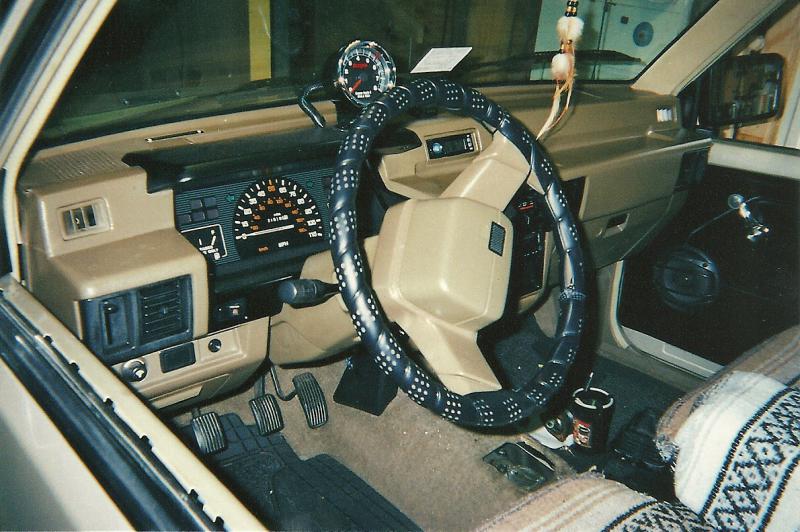

    An after-market tach will cost you roughly $50, easy enough to install. I have yet to hook mine up to the connectors in the engine compartment: mine runs off the coil and is line-fused per instructions that came with the tach. I'm holding out for a sport cluster, so for now, the after-market works fine.
