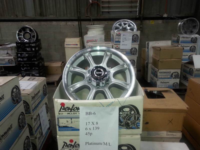

Fordubishi, no way they were a +45 offset then. I have an 8" wheel with a +40 offset(they tuck less than +45mm would) and they tuck with ease, 3/8" clearance to fender lip.
