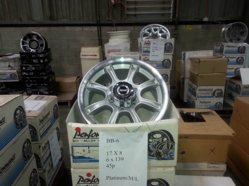

    Hi guys, I have a dilemma. Well, I have 3. #1 : I have found a set of alloy wheels but don't know if they will grief me due to their size (17 x 8). #2 they have made me an absurdly cheap deal. #3 I am broke but I will kick myself if I don't scrape the coin together and buy them if they fit. Here is what I'm looking at - Click image for larger version.
    17" x 8" 38p, set of 5 includes all centre caps and wheel nuts (ignore the info in the pic) Are these going to fit on my rwd Gen 1 or am I going to run into clearance issues up front with the rim and/or tyre?

    wow....love the rims! the offset is huge, but the diameter is also...can you drive to them or obtain 1 to test fit for front upper control arm clearance?...I believe they will clear the bottom rear of front fenders (depending on tire choice).
    She's mighty mighty just lettin' it all hang out
    2,785
    The extremely helpful woman at the warehouse let me take one back to the truck and test fit it. No problemo in the rear but up front the inner lip of the rim touched the upper control arm (just). I was figuring that I didn't have the extra weight of the drivetrain loading up the suspension and I could grind a little off the shoulder of the UCA to gain some clearance. But then I have to factor in tyre profile. When I mounted it up back and looked at the truck from the rear this rim was PHAT. It's one of those "damned if I do, damned if I don't..." deals.

    Should've elaborated that was at full(ish) lock. I can see the front tyres getting real close to the front stabiliser bar too. Funny thing was, I went into this place a month or so ago when they decided they were closing up shop and they had a full pallet of 14's for $40 each (they were slightly transit damaged - little chips in the clear coat here and there). I sat on the fence on that one thinking I could go back later a grab a set (not much demand for alloys in 14"). Nope - gone. But now these have come up and I was offered an even better deal on these 17 x 8's. OH THE HUMANITY!!?!
    1,511
    yes mostly anything more than 7" wide you run into that issue, same with my 7.5" with +35mm offset. There is a steering stop on the back of the spindle that you can adjust to shorten the turning radius so they won't rub. Yes I know not the most ideal solution(less turning radius) but that is what happens when you put bigger/wider wheels on anything really.

    They also have a set of 17" x 8" 45p as well. The offset is enough for me to believe I won't run into fouling issues on the inner edge of the rim but that is a BIG offset.
