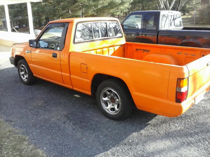

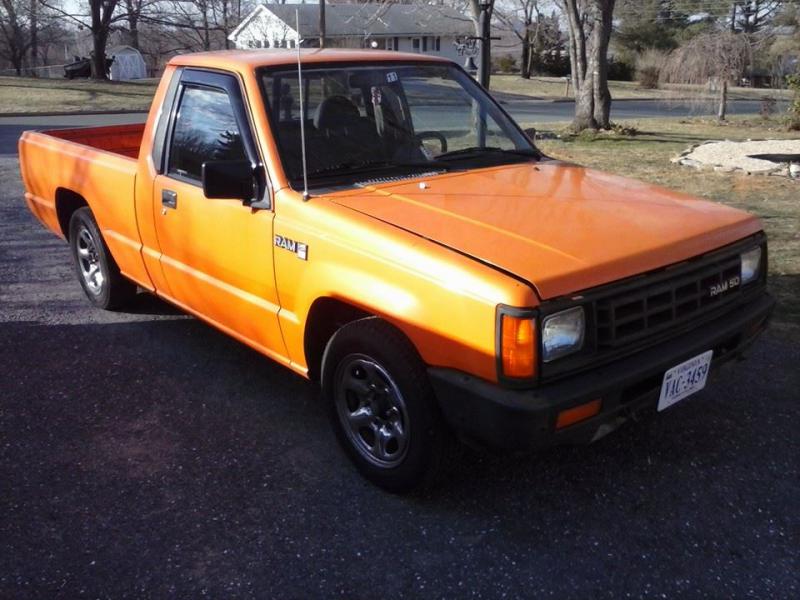

    What's up forum people? just purchased a new to me 1988 Dodge Ram 50 a couple days ago. haven't had a chance to dig into it too much other than fixing a few wiring issues. This little truck only set me back 500$. Don't know a whole lot about these little trucks other than it seemed like a perfect truck to make into a little low rider. I'm not for sure but I think she has a set of pathfinder wheels on her. It has buckets out of a Dodge Neon and the previous owner kept it clean.

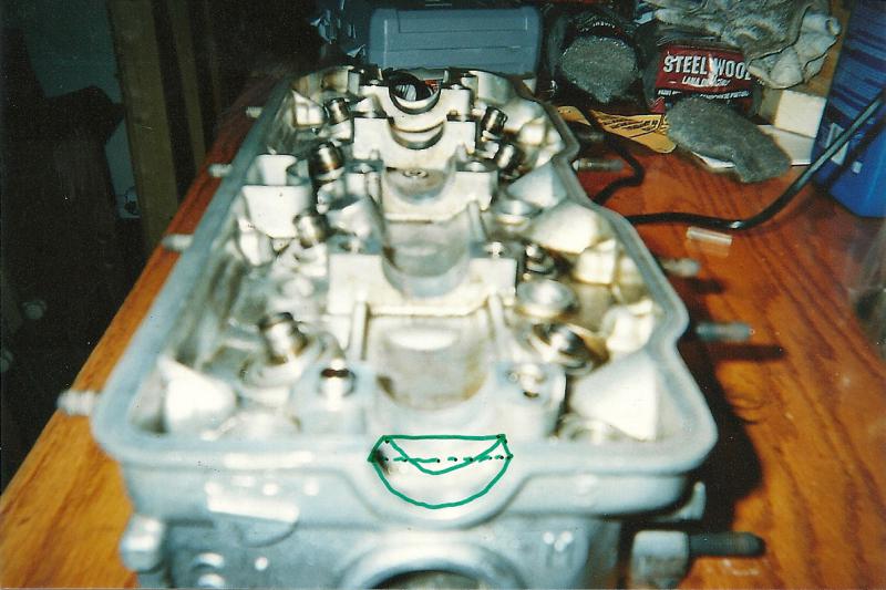

    can you point me towards a reference pic of the moon plug your talkin about? ad last 2 days in advanced auto the guy has told me of there sale on seafoam and I hav gotten it yet, it didn't do much for previous vehicles so I didn't become a believer but im thinkin tracking down some non ethyl gas andgoing 93octane and a can of seafoam through a few tanks and ill fix atleast a few of he issues goin on inside this thing lol
    1,123
    It is literally shaped like a half moon, and it should come standard with the valve cover gasket, along with two rubber grommets for the valve cover bolts.
    When you remove the valve cover, you'll see the half-moon dip in the cylinder head in the back of the engine.
    1,123
    I happened to find a picture of where the half moon goes (outlined in green) at the firewall-end of the head. I forgot exactly why it's craddled like that, but if memory serves me correctly, the end of the cam craddles there just on the other side of the rubber half moon seal.
