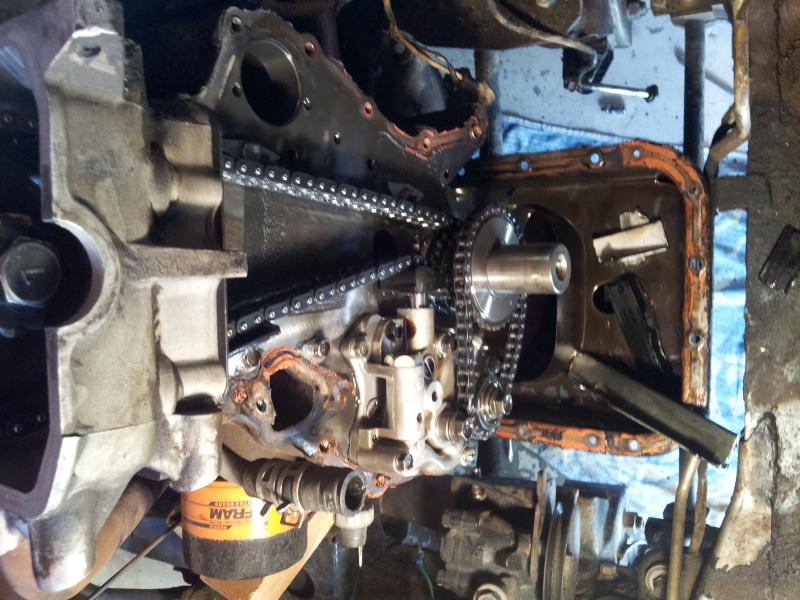

Wow what a morning! Here is a pic of my timing chain and debris. I guess I have the balance shaft elimination kit and whoever put this thing back together did a piss poor job. I jacked up the engine to remove the oil pan and put pieces of 2x4 between mounts and frame but cant get the pan out, can I jack the engine as high as it will go without damaging anything?
You are going to need to clean out the pan. At this point you might as well pull the engine and make it easy on your self. The trans will hit the firewall before you can get it high enough to get it out. Unless you can see some other way of doing it. Sucks you broke the tensioner.
Tomorrow is another day, I'm going to put the pan back up with a few screws and let the engine back down and remove the header then jack it back up as far as I can go, it looks like it might come out from the top side because I removed the radiator. I will let you know if it works! I really don't want to pull engine. Thanks Camoit
Once you have the radiator out you only have a couple of other lines holding it in there. But I have herd you can pull the pan with out pulling the engine. It's just a pain. But you have 4X4 so IDK if you can. Just don't mess up the trans mount by torquing it up. You should be able to get a timing kit from rock auto. there might even be a good discount code in the discount thread.
Successful morning! I was able to remove the oil pan up thru the front. When I got the engine up higher it was easy access to the oil screen, removed the screen and the pan came right out. Here is a pic of the pan draining before I pull it out. I know for me this was easier than pulling the engine, lack of space,no engine hoist, engine stand etc. Man is that pan full of crap, it looks like the screen and filters have done their job. Thanks Camoit for your replies!
