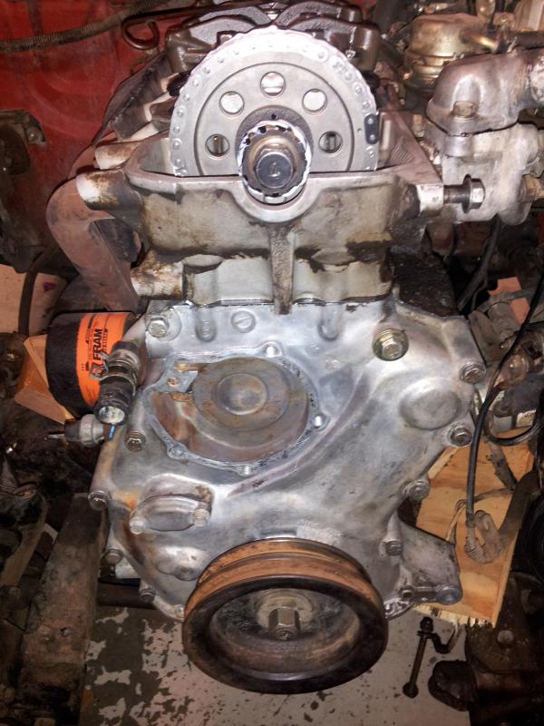

    Wow what a morning! Here is a pic of my timing chain and debris. I guess I have the balance shaft elimination kit and whoever put this thing back together did a piss poor job. I jacked up the engine to remove the oil pan and put pieces of 2x4 between mounts and frame but cant get the pan out, can I jack the engine as high as it will go without damaging anything?
    You are going to need to clean out the pan. At this point you might as well pull the engine and make it easy on your self. The trans will hit the firewall before you can get it high enough to get it out. Unless you can see some other way of doing it. Sucks you broke the tensioner.

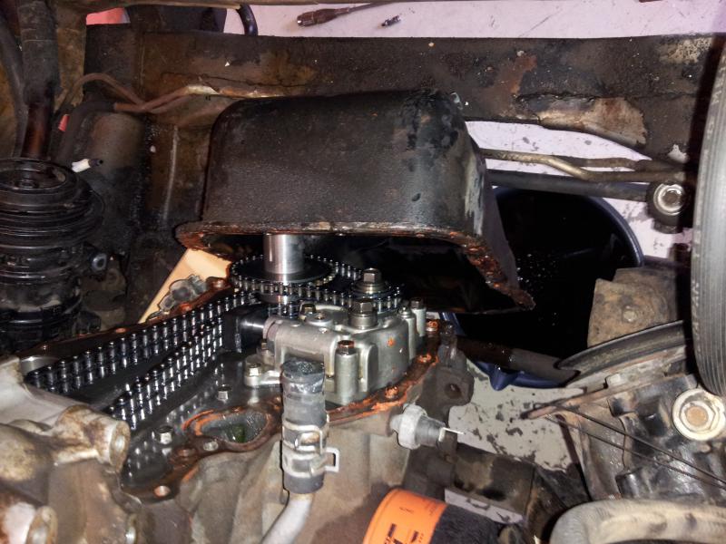

    Successful morning! I was able to remove the oil pan up thru the front. When I got the engine up higher it was easy access to the oil screen, removed the screen and the pan came right out. Here is a pic of the pan draining before I pull it out. I know for me this was easier than pulling the engine, lack of space,no engine hoist, engine stand etc. Man is that pan full of crap, it looks like the screen and filters have done their job. Thanks Camoit for your replies!
    Keep us updated. Also in the link section there is a free picture resizing tool you can DL You can rotate pictures and do other things to them. I use it all the time to batch resize.
