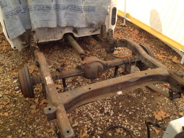

    I got some work done yesterday on the truck. I stripped down the frame removing the gas tank, cross members, exhaust, shock mounts and spare tire. I also pulled the carpet so I can raise the end of the trans tunnel. My parts should start coming in by next weekend so I'd like to do the step notch next weekend.

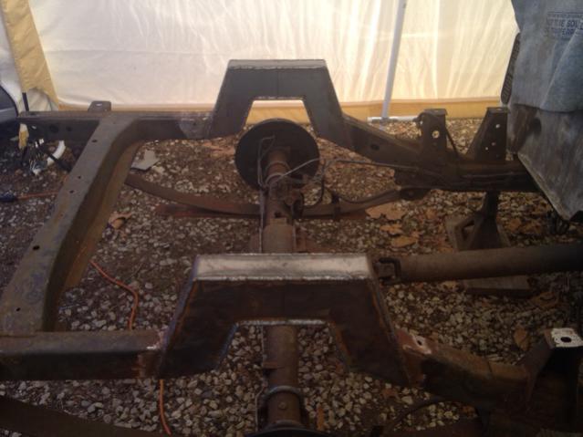

    Got one step notch done yesterday. The weather was crappy and the ground in the carport was starting to flood so I called it a day. But I'm excited it's finally starting to look like a bagged truck not just a stripped frame. I still got a long way to go but its nice to see progression, I couldn't get out there last weekend.

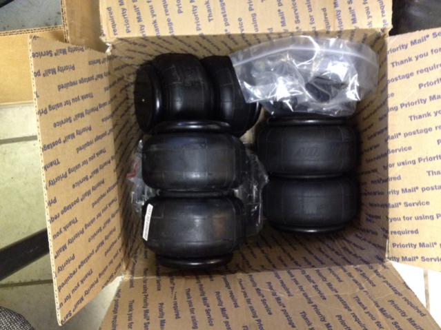

    Oh yea and I got some more boxes this week.

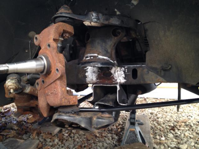

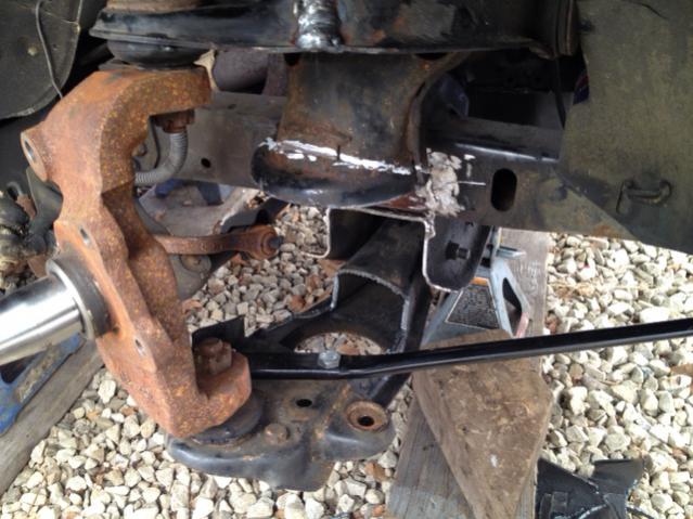

    Today I got the other step notch done. I tore down the front end and rough cut the spring pockets so I can pie cut the upper control arms. I can lay out on a 23" tire now so we'll see where pie cutting it takes to. I'm taking measurements from the frame not the engine crossmember because I'm plan on z-ing it in the future.
    08-20-2013
    191
    blackwood, nj
    1995 Mitsubishi Mighty Max

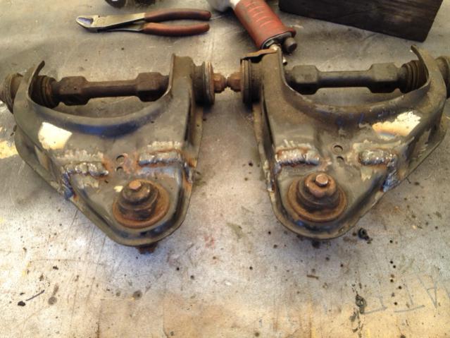

    The upper control arms are pie cut, now I can run a 27" tire. I started cutting out the spring pocket and lower control arm to fit the bags but ran out of time. I'm gonna cut the pocket more along the white line to get the upper bag mount on a angle so this way the bag collapses evenly. I'm still on the fence with triangulating the lowers, I think i'll be alright with the strut rods for now.
