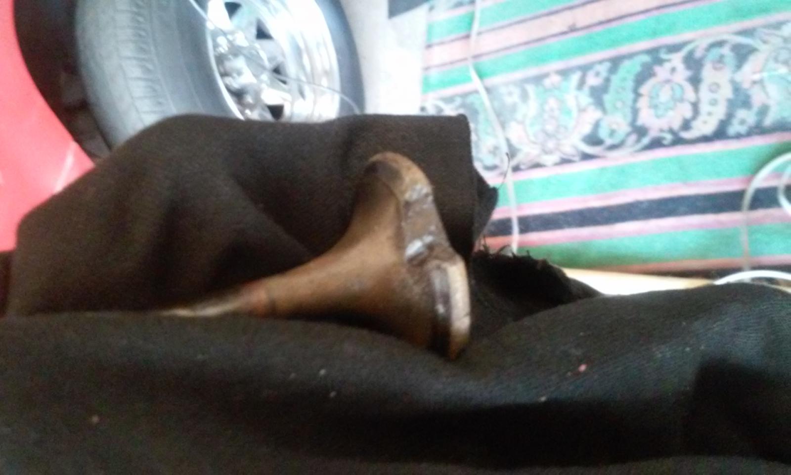

    I believe I have found and solved my issue with the truck, a burned, actually broken exhaust valve on cylinder 2, so, the junkyard head was gone thru, valves lapped, checked for clearance and generally cleaned up and made pretty, new valve stem seals, new gaskets all around, even for the fuel pump, and thermostat housing. here are some pictures of the head with the problem, hopefully tomorrow I will get done and get her started, I need to plate her so I can enjoy my baby. My wife gets jealous, says I spend way more time with my truck than with her... well, maybe jajaja

    Poor valve. Well at least thats all it needed was just a head swap. While you still got it opened up, how do your cylinder walls look?
