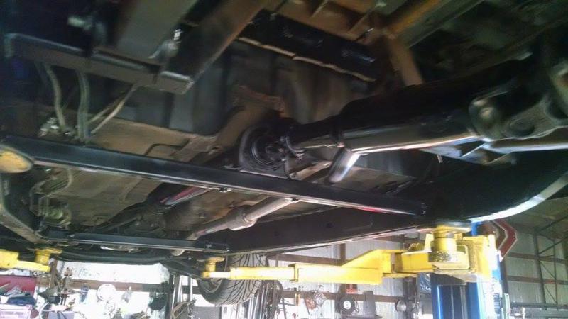

    This is looking good! I wish I would have caught you before you cut the cab up. I went with a two piece driveshaft to avoid that and it works perfectly.Drive shaft 02.jpgDrive shaft 01.jpg

    Thanks guys. Sergio I like what you did with the 2 piece drive shaft. I really didn't think of that cause I was trying to use what I had. But I see you got them crossmembers all cleaned up.

    Yeah, it was laying frame uneven. so we made all new crossmembers and added the carrier bearing for the drive shaft. can't wait to see it finished...of course everyone knows these truck are never done.

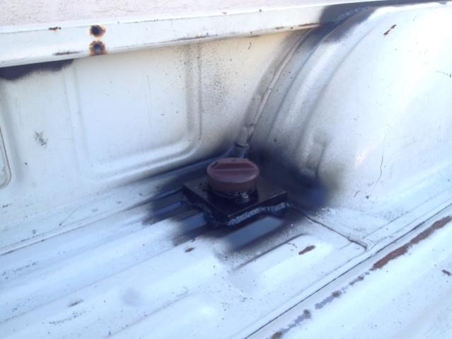

    Nice truck bobbyk.....you did some clean work. I was wondering if you came up with an idea on the filler neck after you relocated your tank. I moved mine in nearly the same location. I have been trying to come up with a solution to making the "gas 'er up location" look as good as possible.

    Thanks guys! Its nice to be able to enjoy it now. And best of all... my son loves it. As for the filler neck I shortened my factory one a few inches and relocated it right behind the drivers side wheel well in the bed. I'll snap some pictures and post them up.

    I know its not the best looking but it serves it purpose. I am planning on cleaning up the bed and doing a bed liner then i'll try to see if I can find a nice looking cap for it.

    That is a nice install of the filler neck. My truck is a project and I can use some ideas on how to complete it. I believe I have some serious OCD or maybe its my ADHD but I focus forever on tiny details. This is one I keep stepping back to evaluate every time I look into my bed. I was last thinking of a wood bed floor and hiding the filler neck up under a trick door.

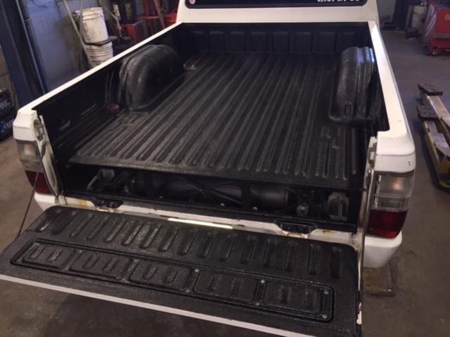

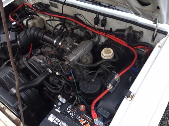

    It's been a while since I posted but the truck has been driving great and I got a few things done recently. I upgraded the stock alternator to a 75 amp and did the big 3 upgrade. After seeing some pictures in another post I decided to put blue leds in my cluster to match the ones under my dash. Also I finally got the bed all finished and decided to go with the herculiner roll on bed liner. I have to say I'm pretty impressed with their product so far. That's about it for now, just looking forward to show season in the northeast.

    What's the Big 3 upgrade?
    08-20-2013
    191
    blackwood, nj
    1995 Mitsubishi Mighty Max

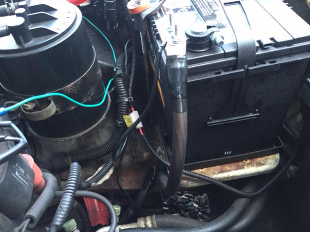

    Upgrading your power wire and grounds from your battery with a thicker gauge wire. I choose to use 0 gauge wire. So you do positive terminal on the battery to the alternator with a fuse inline close to the battery. Then you need to do ground terminal on the battery to chassis then to engine. Which would give you the big 3 but I did the grounds the same way that it came from the factory. It's negative terminal to body to frame then to engine. Doing this helps to provide the battery and charging system with optimum power when you have extra drawls on the system such as compressors and a amplifier. I'll post some pictures later.
