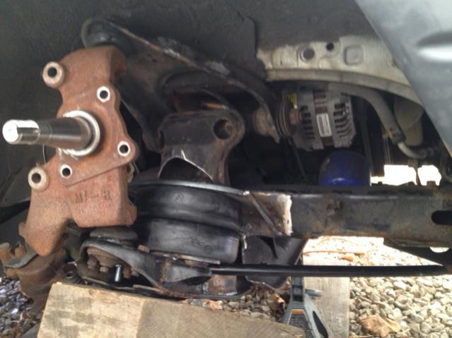

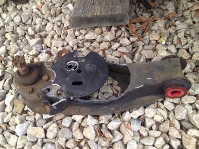

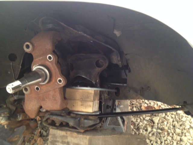

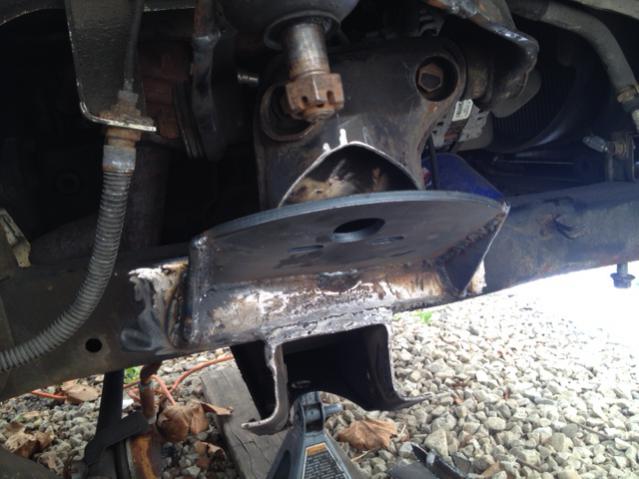

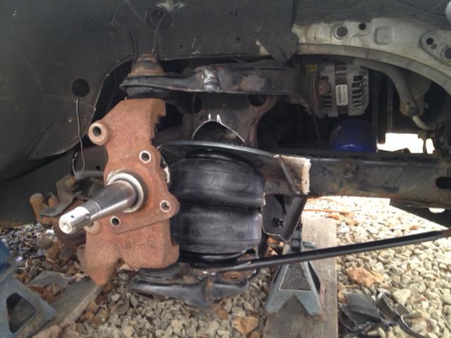

I had to work today so I didn't have much time on the truck, but I got a little done. I figured out my front bag placement now I got to clean up the cuts and prep it to be welded. I decided to keep the strut rods but mounted them inside of the lcr so it didn't interfere with the lower bag plate. I'm hoping to get a full day on it soon, it's hard to get stuff done with a couple hours here and there. But I'll take what I can get.
