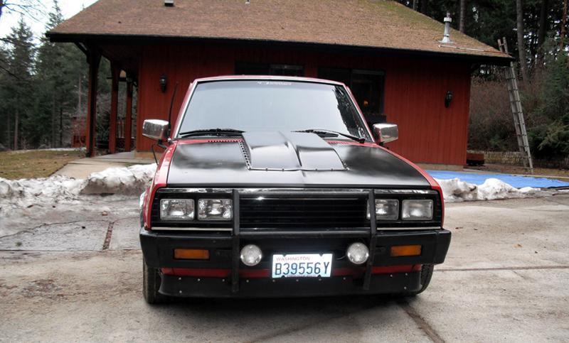

    I was the one that used the rubber trim. Works great and is flexible and last long time.

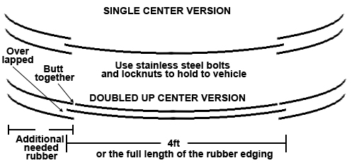

    I used the floor edging found at Lowes Hardware. They had 2 different kinds, one was softer then the other and I went with the stiffer one. The pieces came in 4 ft. lengths if I remember right, so you will need to add to them on the sides and I also doubled them up for extra strength on the truck, single style on my MR2.

    I believe Brad's talking about rubber coving, and from the photo, that's what it looks like. It's used as a baseboard, sort of. VERY clever, Brad, and nice execution of the installation.
    That will be in the flooring department, and they do sell it in longer lengths, black and brown are all I've ever seen it come in.
