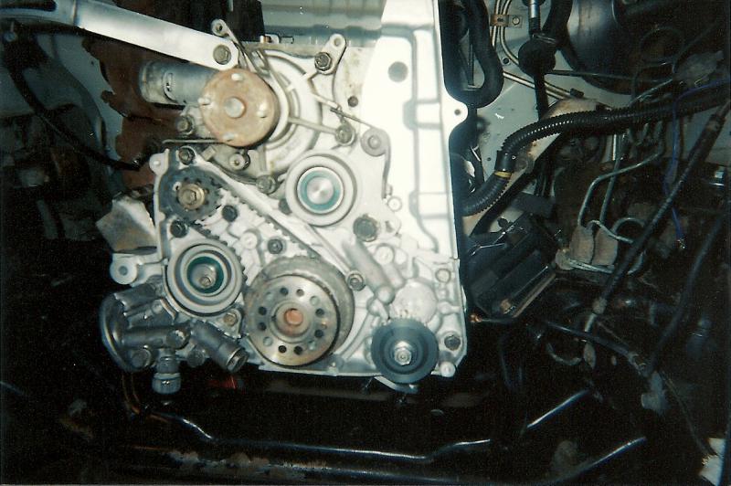

    Here's how I did this on my 2.4:
    http://www.mightyram50.net/vbulletin...ll=1#post26676
    You’re going to have to remove that crankshaft center bolt...the pulley comes off first by removing the four small bolts. The crankshaft bolt holds on the timing gears, and while the book says you need a “helper” to assist you, I managed to do this by myself. It involves taking the inspection cover off the bottom of the transmission. (Be mindful of the nuts and bolts and where you place them). My trans is a 5-speed, but the automatic has the same basics: a flywheel with teeth for the starter. You’ll need to put a screwdriver on the right-hand side of the bottom of the bell housing, in one of those teeth, to keep the engine from turning while you loosen the crankshaft pulley bolt. Do not use the starter motor hole for this task. With the 19MM socket and ½” drive handle set to remove the bolt (counter-clockwise) you’ll do well to put a 24” or so piece of pipe on the ratchet handle…some call it a “cheater bar”, others call it “leverage pipe”. If it’s behind your front seat, it’s a “defense mechanism”.
    You can hold the screwdriver in place, on the surface of the bell housing while engaged in the flywheel gear-tooth, and pull (or push) the ratchet with your other hand. Using your leg is fair game. It shouldn’t take much to get the bolt loose, and from there you can just ratchet it off.
    A wheel puller removes the timing gears fairly easily once the center bolt is off. Now you can see the work before you.
