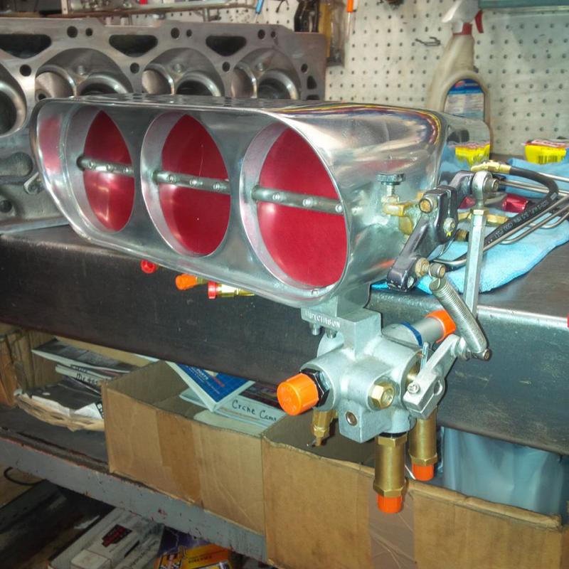

    I don't know why they make them have such a high flow when we can get away with 3GPH. It's a 13 gallon tank and we can run for 6 + hours with out filling up. It's not like we are blown alcohol injection where you set the idle using an air compressor and leek tester while listening to the sound of it while seeing how many CFS it's blowing through. The fuel just shoots in there and deflects off an angle plate. Thats there version of an injector.
