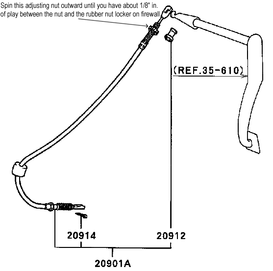

    Clutch is going out but can't afford to buy a new one yet. How do I tighten the cable clutch? It was done once before but cannot remember how to readjust it.
    If it's the cable type, open the hood and against the firewall grab the clutch cable and pull it away from the cab like your going to pull it out. Spin the adjusting nut so there is about 1/8 in of play between the nut and the rubber nut locker on firewall.
    See below

    As any clutch wears, that takes up free-play in the release mechanism, so it's better to err towards adjusting it a bit too loose, rather than too tight.
    The star nut for cable adjustment should leave at least a few mm of free-play room when you tug the cable housing away from the firewall. The more slack you allow, the less often it will need adjustment to add more free-play, but too much slack can result in the clutch never fully disengaging at all, resulting in hard gear shifting, low RPM or stalling-out in gear with the clutch pedal down, and increased wear on the clutch. Adjusted too tight, that'll soon result in the clutch never fully engaging, causing slippage and increased clutch wear.

    One thing occurs to me now: there should be a rubber bushing, about a 1/4" thick and sandwiched between washers, between the adjuster star nut and the firewall fitting where the cable passes thru. Has that bushing perhaps gone missing?
