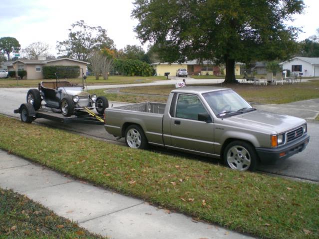

    I bought mine from Hitchweb but I guess there all sold out. It mounts to the frame and can use it with or without a bumper.
    08-25-2012
    171
    Winter Park, FL
    1994 Mitsubishi Mighty Max
    I tow a small trailer with it, even flat towed a 52 Dodge on tow dolly
