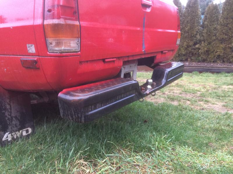

    Would stock bumpers off of an 86 mighty max 2.6ltr work?

    Quote Originally Posted by Diesel mightymax View Post
    The bumpers will bolt on but the front bumper is not the correct bumper. The 1983-84 Mitsubishi Pickups had the turn signal in grille. The 1985-86 had the turn signal in the front bumper.

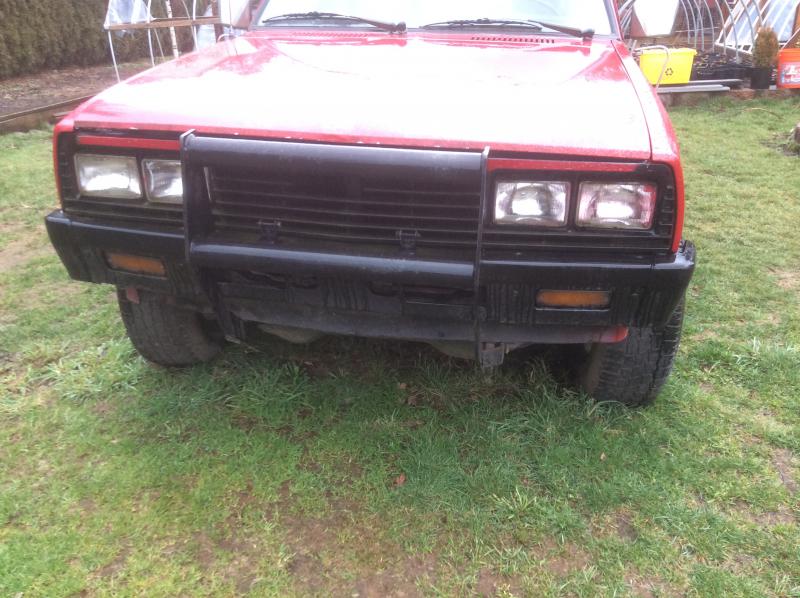

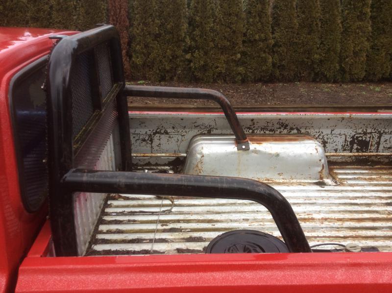

    IMG_0230.jpgIMG_0231.jpgIMG_0232.jpg So this is what I've found near to me. the truck is whole. 2.6 Ltre. I only need the bumpers an roll bar is this worth me acquiring? I may be able to use the radiator and fan clutch also?

    4D55-T
    Id leave the roll bar unless you're dying for it as that's not factory. Radiator will work not fan clutch. Get the mudflaps and grille guard. Rear bumper is stock for ram 50.

    If you have a place to park it as a parts truck, it might be worth getting the whole truck. Not much question that you will get your money back selling parts from it, plus all the things you need for your own (door panel?).
    The parts truck I bought (2nd generation) cost $300 (they would not take less) but I've sold that much in parts. PLUS I learned a lot about the trucks by dismantling. So, depending on what they want for it, it could be a good investment...even if you only break even.

    I think that is the factory rollbar for the ram 50 but you have to drill holes into the bed to install it. Those holes quickly turn to rust.
